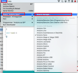

STEP 3: Go to Tools->Boards->Boards Manager.

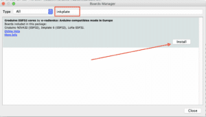

STEP 4: In new window, enter “Inkplate” into search field. One option will appear, select “Install” next to it.
STEP 5: The process itself does not last long, and after it is done, you can close Boards manager. Now, under Tools->Board you have some new options. Select Inkplate 6(ESP32).
