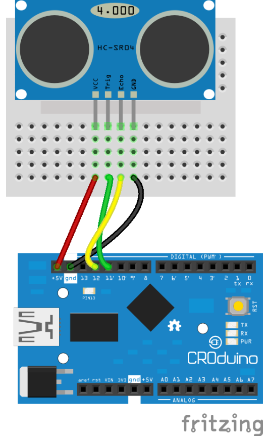

To begin with, let’s connect the module to Dasduino/Arduino:
