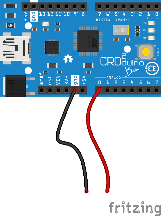

CONNECTING
We need two cables: GND (-) and (+). GND connects to GND, and (+) to measure the analog pin 0 Dasduino. By no means, do not connect voltage greater than 5V to Dasduino!
