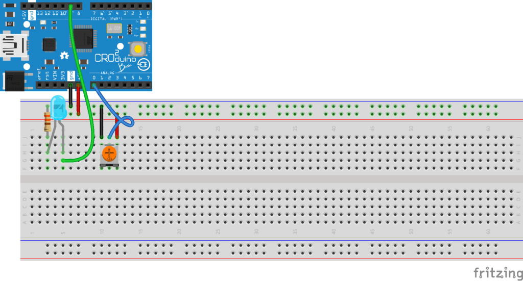

If you have a potentiometer at hand, connect it according to the picture below, change the position and monitor changes in Serial Monitor.

We connect the cathode(shorter pin) of the LED diode through 330ohm resistor to the gnd, and the anode(longer pin) to the digital pin(PWM)9 as shown in the picture below

In the end we will show how to turn analogue readings(0-1023) to PWM(0-255). From the example with the potentiometer and LED diode we used for testing INPUT/OUTPUT, we will read the potentiometer status, and depending on it, amplify/decrease the light of the LED. Although, at first glance, it looks very simple and easy, the problem may arise due to the range. Let’s see in the example below, which IS NOT CORRECT:
int led = 9;   // LED on the pin 9
int ulaz = A0; // potentioneter on the pin A0
void setup() {
pinMode(ulaz, INPUT);
pinMode(led, OUTPUT);
void loop() {
int ocitanje = analogRead(ulaz); // defining new variable reading
// in which we save the analogue reading(0-1023) of the potentiometer
analogWrite(led, ocitanje); // the LED's status is set according to the values of analogue readings of the A0 pin
Upload the code and observe what happens. At the full turn of the potentiometer, the LED went out four times, even though we expected the values to range from fully turned off to maximum illuminated. The reason for this is when the reading variable has a value of 256 (for PWM maximum of 255), analogWrite () defines it as 0, or completely extinguishes the LED, because the PWM accepts only 8bit (0-255) values. So, 256 becomes 0, 257 becomes 1, 258 becomes 2 and so on. In order to avoid this, we introduce the integrated function map(), which will map the value into default range. We use it in the following way:
