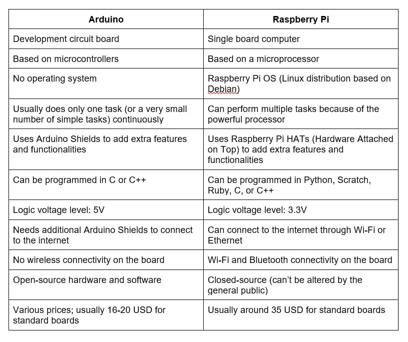

Arduino Raspberry PI Side-to-side comparison
To make the differences even more clear, we thought a side-to-side comparison would do the trick. This way, the differences should be more apparent at just a glance.
Arduino vs Raspberry Pi – what’s the difference
