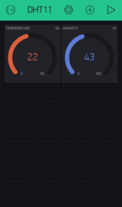

In the same way as in the first example (link), we create a new project, but this time, instead of the button, we will use two new widgets called “gauge” which will display the measured data.
We connect the temperature to the virtual pin V6, and humidity to V5. Virtual pins always have V+number (V0, V1, V2…) marks which serve to send any type of data from the microcontroller and back to the application.

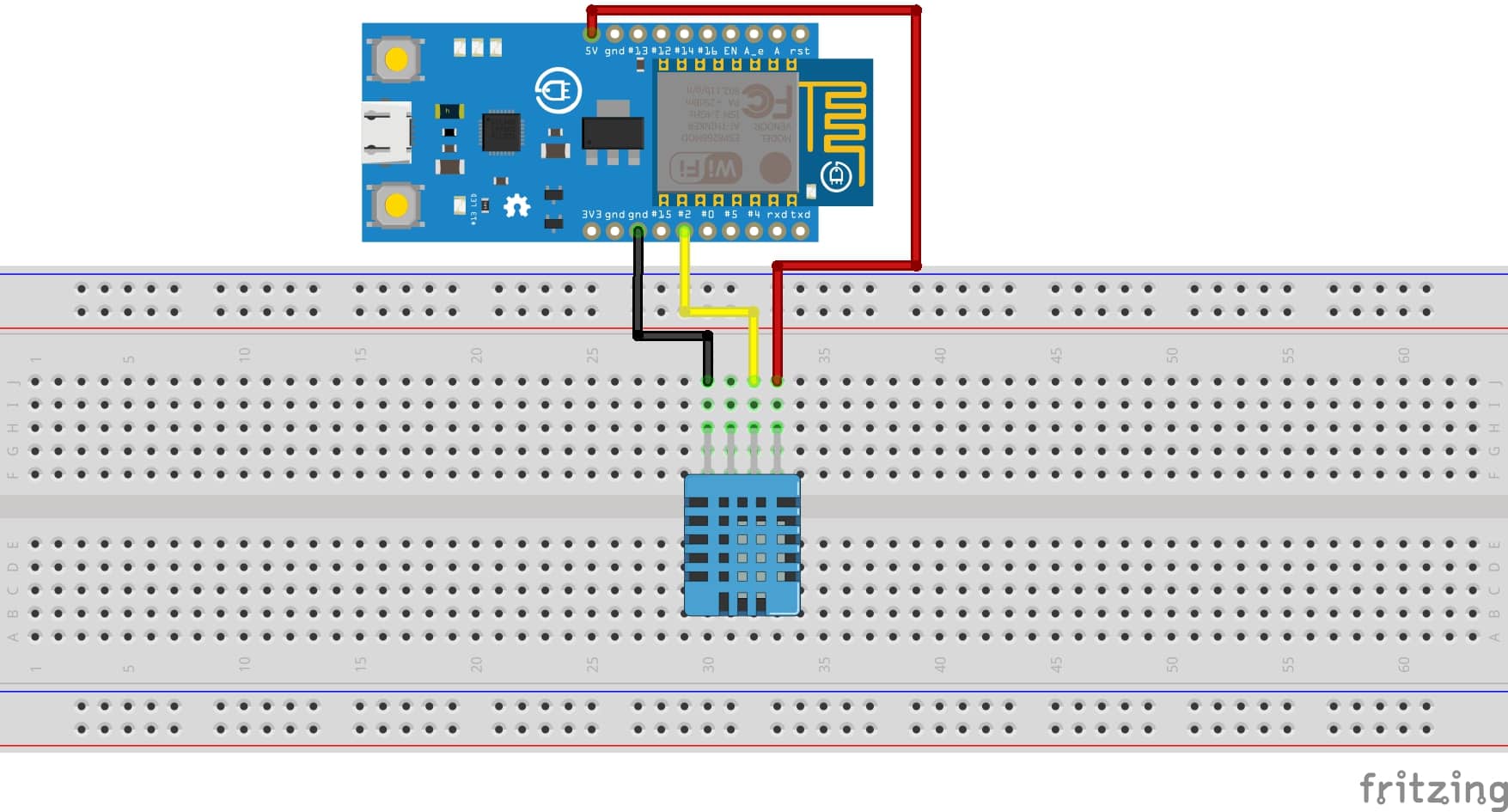

CONNECTING
