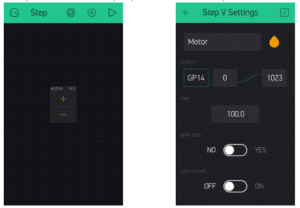

To the newly opened project, add the “Step V” widget which will enable changing the PWM signal on Dasduino Connect’s pin, and thus controlling the motor rotation speed. Connect the Step to pin 14 as shown in the picture.
