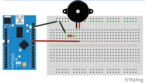

HOW TO CONNECT THE BUZZER?
Paying attention to polarity, we will connect the negative pole of the buzzer to the Dasduino gnd, and the positive one to the Dasduino’s 9th digital pin. You can connect one pole through some type of resistor, for example that of 100Ω. Note: the buzzer must be connected to the PWM pin, if you do not want humdrum sounds. Do not forget to take the sticker off the buzzer!
