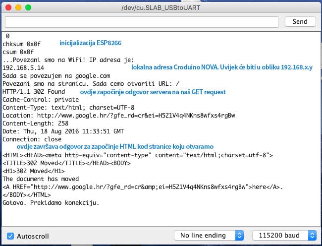

Only thing that remains is to see the result on the Serial monitor. At the start we have a response from the server, similar in form to our GET request. After that we’re getting the HTML code of the page we’ve wanted to open. Depending of the page we’re opening of course we will get the HTML code for each of them. If we are sending informations on a server (for example data.sparkfun.com), we will get get a response to our request, which usually contains information as: is the request valid, time of receiving the request, unique record code in the database. It looks something like this:
It appears that google.com/ has a  redirect to http://www.google.hr/?gfe_rd=cr&ei=H521V4q4NKns8wfxs4rgBw, in my case. You will get a bit different gfe_rd. Bare in mind that you won’t be able to open websites that work on https, they are using SSL certificates (like for example. e-radionica.com).

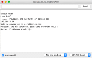

WHAT TO DO WHEN IT DOESN'T WORK?
It is possible that you have typed wrong  SSID or password for your WiFi network. It will look like this (so fix it!):
If you try to connect on a web site that works over HTTPS protocol, in other words, it has SSL certificate, you won’t get a response. You need to use different code – soon more about it!
