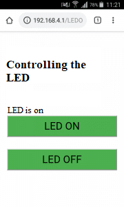

We use the ESP8266WiFi library in the code, but we do not need to install it because when we add the ESP8266 module to the board manager, this library is also installed. To use the Dasduino Connect as an AP, you do not need to change anything on it, we just upload the appropriate code and the Dasduino becomes an AP. In order to test how it works, we will connect the LEDs with the corresponding resistor for each diode to pin 4 and 5. When we connect to the Dasduino and visit the web site, we should see the same display as is in the image below. When we click on the LED ON, we turn on the LED and when we click on the LED OFF, we turn off the LED connected to pin 4. The same applies to the LED connected to pin 5, and in front of each group of buttons, the status of the LED which is controlled by the buttons is displayed.
In the image below, we see what the mobile phone display for a single LED looks like and, as we can see, it is of the appropriate size because in the code for the web page we have added a part that scales the page display depending on the device on which it is displayed.
