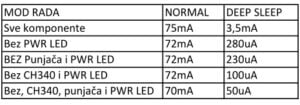

The last operating mode, in which we “put Dasduino Connect to sleep” is DEEP-SLEEP mode, using which we shut all the systems down, except for the RTC (real-time clock) and the consumption in this mode is 17uA (3,3 V power supply), i.e. 50 uA (5V with a regulator and pull-up resistors) which is low and acceptable for projects that are battery-supplied. To reduce the consumption to the uA you must remove the CH340 USB driver, along with the battery charger from the board. Make sure to switch the code to the board before removing the CH340 chip, because later it will not be possible.
Power consumption in the normal operating mode and DEEP-SLEEP is shown in the following table (5V power supply).
