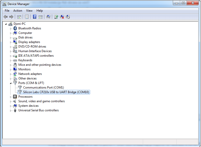

Checking the properly installed drivers can be made in the Device Manager (right click on My Computer, then Properties, Device Manager or Upravitelj uređaja). Under Ports (COM & LPT) make sure to have something like the picture below.
