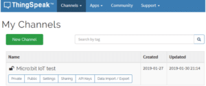

Once you have successfully completed the registration, make a channel which you will use for sending data from micro:bit. In the main menu click Channels and then My Channels. On the channel page click New Channel:
Click Save Channel and you channel is created. The channel page will open. For now, you are only interested in the key for sending data. Click on API Keys for access to it. It is called Write API Keys. Copy and save it somewhere temporarily.

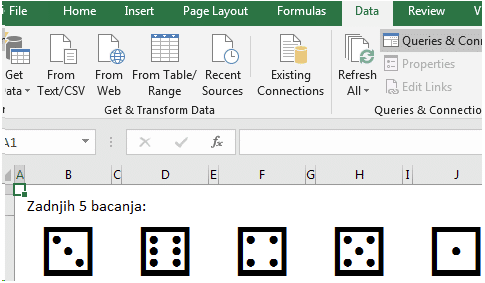

The possibilities are not numerous, but they will provide a more simple insight into data. Channel data can be exported in JSON, XML and CSV formats and then displayed or processed in more detail in programs such as Excel. Data can also be directly accessed. Excel, for example, supports data retrieval over the link, and also their refreshing. In the example below, via link https://api.thingspeak.com/channels/700130/fields/1.csv?api_key=AC6RDIWKNTN2QXPI&results=5, the last 5 values are retrieved and then graphically displayed. (The link is downloaded and updated (results=5) from the site where you have downloaded your API writing key.) Clicking the Refresh All button, the data is refreshed and graphic representation is updated:
Find Excel .xlsx file here. For those of you who are more advanced, check a call set for the application Postman (ThingSpeak.postman_collection.json).
