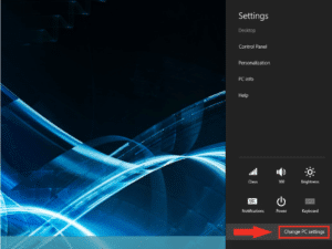

1. Hold Windows button, then press C key (on the keyboard), to open Charm menu. Click on “Settings”, cogwheel which appeared in the right bottom of the screen.
2. Click on “Change PC Settings”

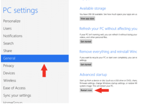

3. Click on “General”, then “Restart now”, which is under “Advanced startup”. If you are using Windows 8.1 version, please follow “PC Settings – Update & Recovery – Recovery”.

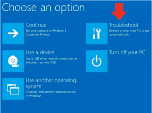

4. After the reset, click on “Troubleshoot”.

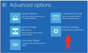

5. “Advanced options”
6. “Startup Settings”

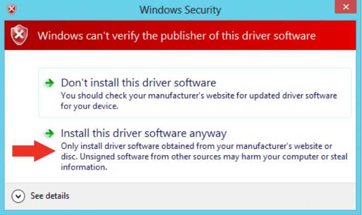

9. After the restart, you will be able to install drivers. Windows will give you a warning while driver installation, in that case, choose “Install this driver software anyway”.
