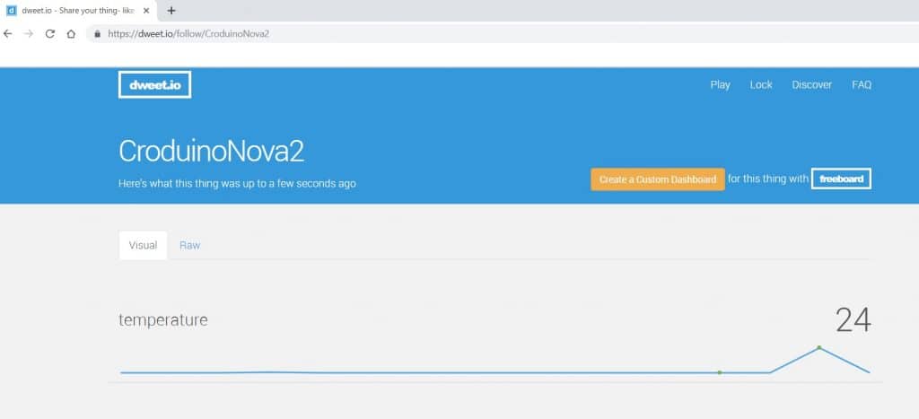

Dweet.io also allows us to graphically display the data we send from our sensors. In order to get a graphical display of the information we sent to dweet.io, we only need to enter the following address to the Internet browser: https://dweet.io/follow/OurName (since we use DasduinoConnect in the name example, our URL will be https://dweet.io/follow/DasduinoConnect) and the information we sent to dweet.io will be graphically shown under the name DasduinoConnect. An example of a graphical representation of the temperature we send to dweet.io with Dasduino Connect is shown in the image.

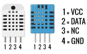

As an example, we will use the DHT11 temperature and humidity sensor and send the measured values to dweet.io. Connecting the DHT11 sensor to the Croduino Nova 2 is very simple because, to the sensor, we need to connect +3.3V to the Vcc pin, GND to GND pin, and DATA pin to Dasduino pin 5. The pinout for the DHT11 and DHT22 sensors is shown in the image, and as we can see they have the same layout, which allows us to easily replace them if necessary (in the code, we only need to change which sensor we are using).

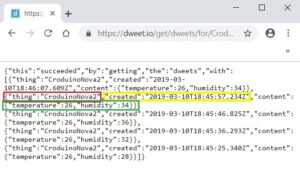

In the image, we see what sending the data to dweet.io. looks like. Red indicates where the name of the device (that we have selected in the code) from which we are sending data is written.
The yellow rectangle shows the part where it was recorded when the data was sent, and the green one shows the data we have sent. We can also see how only the last 5 pieces of data sent were saved. We have selected DasduinoConnect as the name in the code, but we can change that, and then, when searching, in the web browser we need to enter the corresponding name that we have selected.
