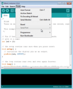

1. FTDI drivers aren’t integrated inside Windows OS. Connect Croduino board to your PC and open Arduino IDE. Now click on “Tools – Serial Ports” and if you aren’t finding anything there, you’ll need drivers. Let’s go get some!

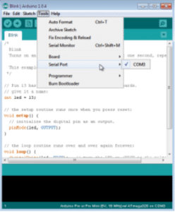

3. Run previously downloaded file and follow the installation steps. If everything is all right, under “Tools – Serial Ports” inside Arduino IDE, COM port shows up.

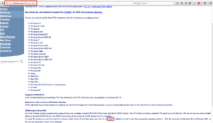

1. Before we connect Croduino or some other FTDI device, let’s download drivers. Follow the link to official FTDI website and choose “VCP” (Virtual Com Port) option at the bottom of the page.

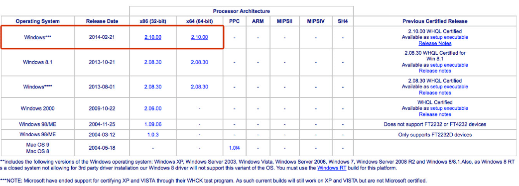

2. Choose 32 bit or 64 bit version. If you are sure of a version which you are using, skip steps 3. and 4.

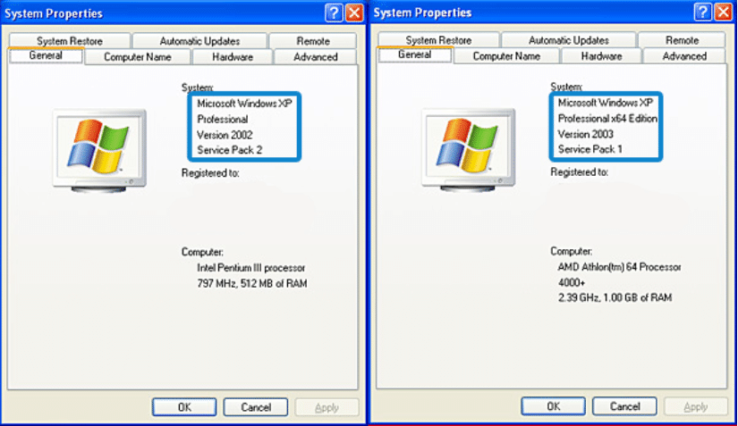

3. Open Start menu, right click “Computer”, then left click on “Properties”.
4. Under “General” tab look for the version which you are using. The picture below shows 64 bit OS. If there is “Microsoft Windows XP Professional x64 Edition …” under “System”, your system is 64 bit. Otherwise, your OS is 32bit. Briefly, the left picture represents 32 bit, unlike the right, 64bit OS.
5. Returning to FTDI, ie. FTDI website. Right click and “Save as” at column which coresponds to your OS. Alternatively, you can follow these direct links: for 32bit or 64bit. It is possible that on these direct links older driver versions can be found.

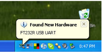

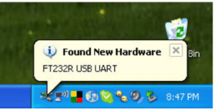

7. It is time to install previously downloaded drivers. While connecting Croduino to PC (when drivers aren’t installed) a small pop-up balloon will show up in the right bottom of your screen “Found New Hardware”.

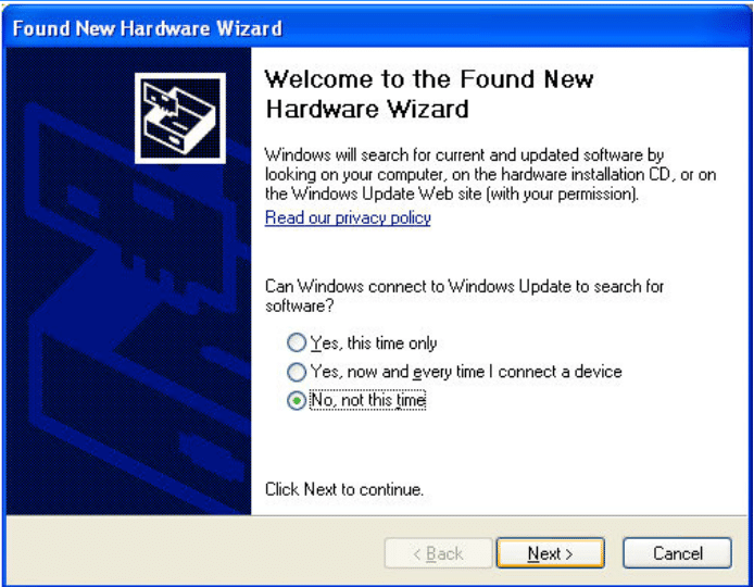

After few seconds a “Found New Hardware Wizard” will show up as well. Choose “No, not this time” and click on “Next >”

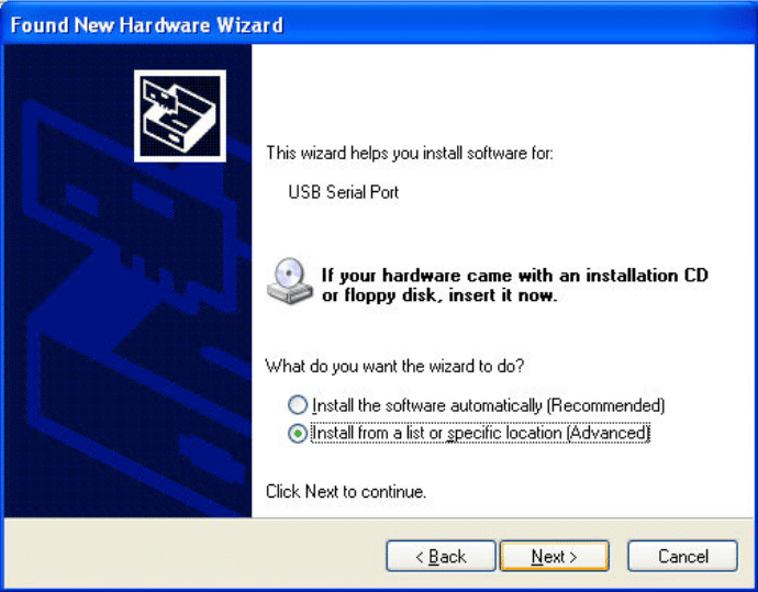

8. At next wizard we choose “Install from a list or specific location (Advanced)”, then”Next >”

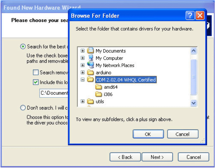

9. It will enable us to install drivers manually. We choose “Browse” and “Browse For Folder” wizard will open. We will find a folder in which we extracted previously downloaded drivers. Click on “OK”, then on “Next >”.

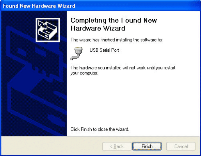

10. After the copying is done, this windows will show up. Click on “Finish”.
11. Few moments after, a new wizard is open. This time it’s for “USB Serial Port” driver installation. Again we choose “Install from a list or specific location (Advanced)” and repeat the same procedure as before (steps 9. and 10.).

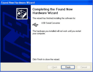

12. After few moments a message shows up which tells us that installation was successful.
13. Now you can reset your PC and use your FTDI devices after.
