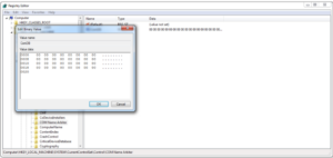

3. Double-click right click ComDB on right panel
4. This will open a window with addresses ports. To reset, enter all zeros, as shown below:
Once you confirm the changes by clicking on OK, our ports are reset. We can also check:

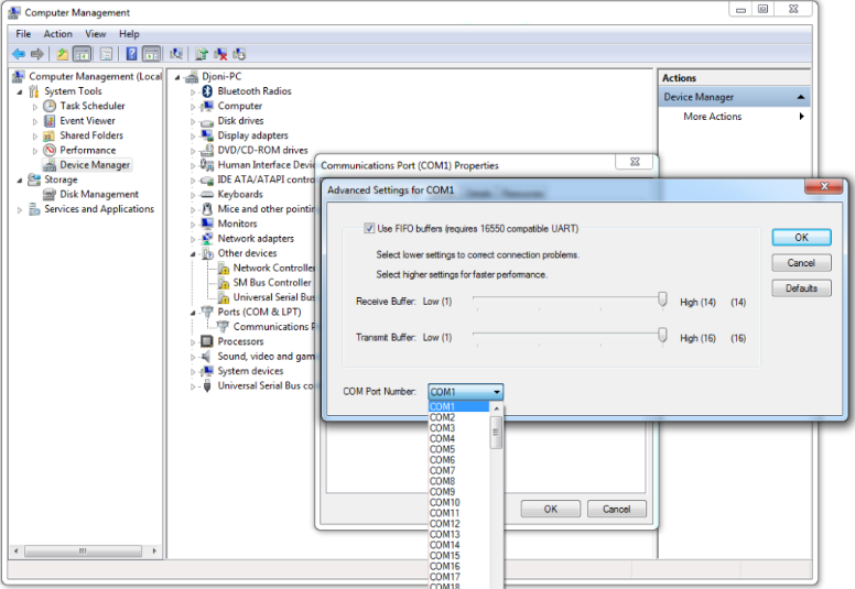

1. Click Start – write devmgmt.msc or simply Device manager, then click Enter.
2. From the middle pane, expand Ports (COM & LPT), right-click on any of the available ports and Properties
3. Choose Port Settings and click Advanced
4. Click on the drop down menu COM Port Number, and we see that all COM ports available.
Check those ports after Windows assignes them a COM port, there should be written “in-use“.

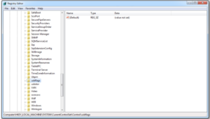

1. Click Start – write regedit then click Enter.
2. Navigate through folders: HKEY_LOCAL_MACHINE\SYSTEM\CurrentConstrolSet\Control\usbflags
3. Right click on folder usbflags, zatim New – Binary Value
4. Name the new file as IgnoreHWSerNum04036001.
5. Repeat step 3., and name new file as IgnoreHWSerNum04036010. Now in the right panel you can see:
