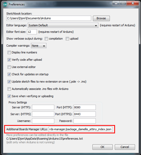

STEP 2: Open Arduino IDE. Go to File->Preferences on Windowsu, and for OS X users, go to Arduino->Preferences. You will se a field Additional Boards Manager URLs. On that spot, you need to paste the following: https://raw.githubusercontent.com/damellis/attiny/ide-1.6.x-boards-manager/package_damellis_attiny_index.json
Confirm with OK.

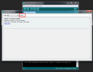

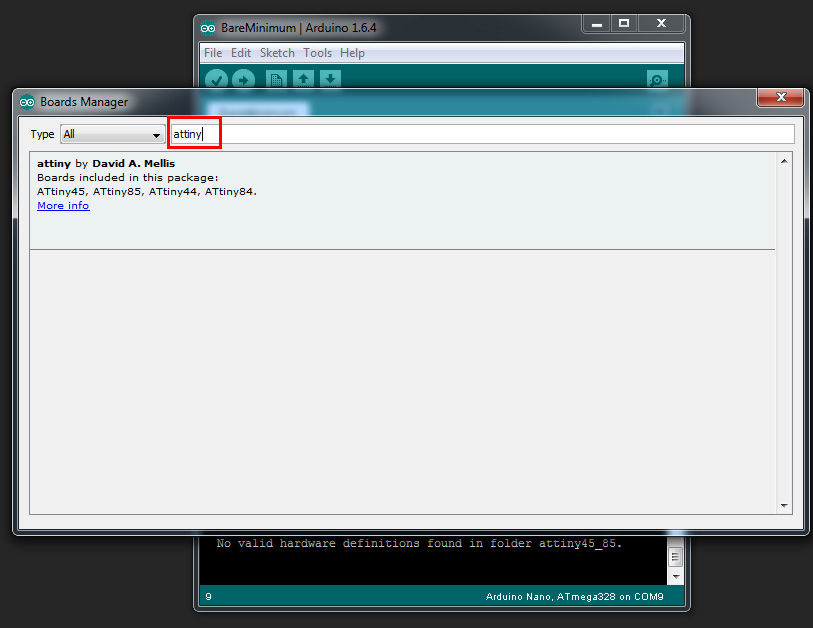

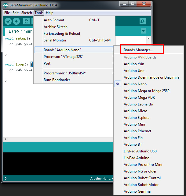

STEP 3: Go to Tools->Boards->Boards Manager.

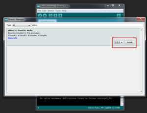

STEP 4: Find: attiny by David A. Mellis, select it and click install.

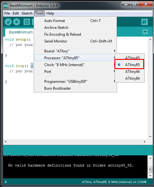

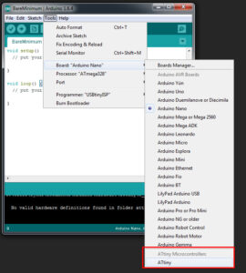

STEP 6 The process itself will take some time, and after it is finished, feel free to close the Boards manager. Now under Tools-> Board, you will have some new options. Select ATtiny.STEP 7: Now under Tools-> Board we have a few more things that we have to set. The changes that we still need to do are: click Processor, then choose ATtiny85. Of course, we need to select the appropriate serial port.

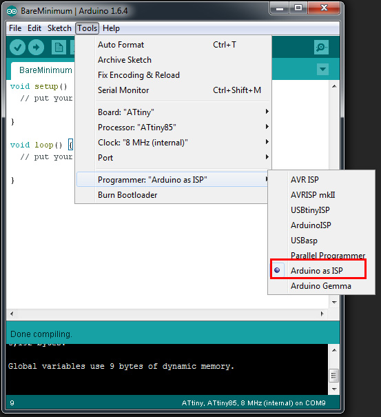

In addition, it is necessary to set the programmer to Arduino as ISP.

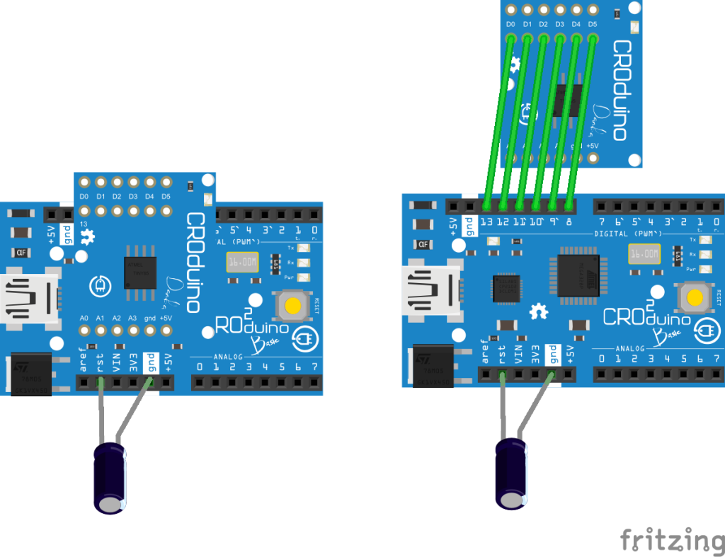

HOW TO CONNECT DAMBA?
NOTE: The illustration shows how to connect to Croduino Basic2, the same goes for Croduino Basic.
Pay attention to the capacitor connected between the GND pins (shorter legs capacitors) and rst (longer legs capacitors). Without it, the capacitors will not be able to insert code to Damba, but it will remain on Croduino which you use to upload code to Damba.
