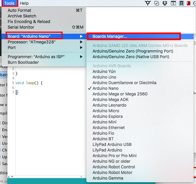

STEP 3: Go to Tools->Boards->Boards Manager.

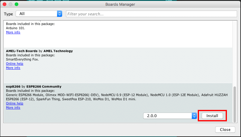

STEP 4: There is esp8266 by ESP8266 Community at the bottom of the list, as last. Choose as version 2.0.0(or the newest in the moment of your installation) and click on Install.

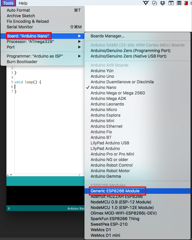

STEP 5: This process will take some time, but after it’s done, feel free to close Boards manager. Now under Tools->Board, you’ll be able to see some new options. Choose Generic ESP8266 Module.

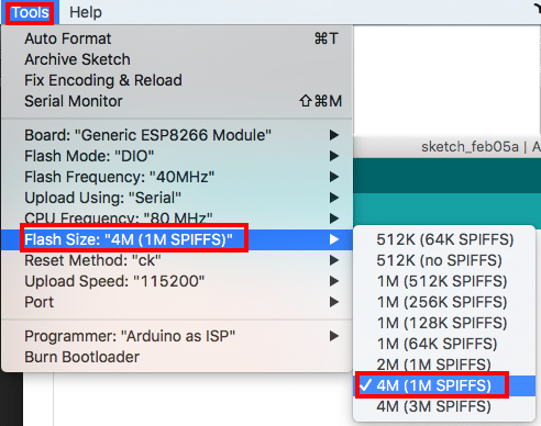

STEP 6: Now, under Tools->Board we have many options. The last change we need to make is under Flash size, choose 4M (1M SPIFFS).
With this done, you’ve successfully set up your Arduino IDE for using with Croduino miniNOVA.
