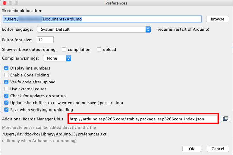

STEP 2: Open Arduino IDE. Go to File->Preferences on Windows, and if you are using OS X, go to Arduino->Preferences. You will see a field called Additional Boards Manager URLs. Copy next link on that spot:
http://arduino.esp8266.com/stable/package_esp8266com_index.json
Confirm with OK.

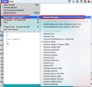

Step 3: Go to Tools->Boards->Boards Manager.

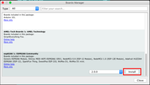

STEP 4: On the bottom of the list, as a last item, there is esp8266 by ESP8266 Community. Choose as version 2.0.0(or the newest one in the moment of installation) and click Install.

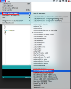

STEP 5: The process itself will take some time, and after it is finished, feel free to close the Boards manager. Now under Tools-> Board, you have some new options. Choose Generic ESP8266 Module.

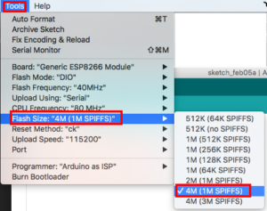

STEP 6: Now under Tools-> Board we have really a lot of options. The changes that still need to be done are: under the Flash size, choose 4M (1M SPIFFS) and as reset method: nodemcu. Of course, we need to select the appropriate serial port.
That’s it! You have successfully set the Arduino IDE for use with Dasduino Connect.
