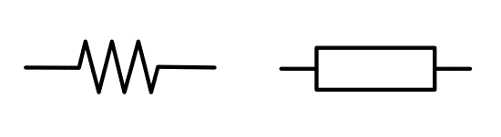

A resistor  is one of the most basic electronic components. It restricts the current flow. There are two schematic symbols for a resistor. The zig-zag symbol on the left is a standard in the United States, while the rectangular symbol on right is the international standard.

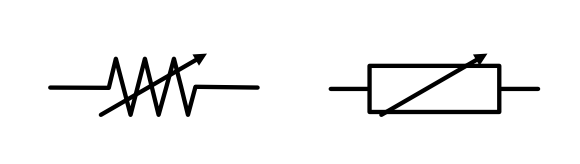

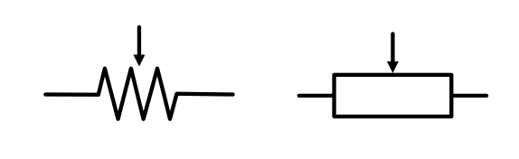

A variable resistor increases or decreases the resistance according to external input. There are several types of variable resistors, such as photoresistors and thermistors. The symbol is very similar to a fixed resistor, with the only exception being an arrow placed across the middle.
A potentiometer is a type of variable resistor used for adjusting the voltage and current in an electrical circuit. The symbol is similar to a fixed resistor, with an arrow pointing towards it from where the output voltage is taken.

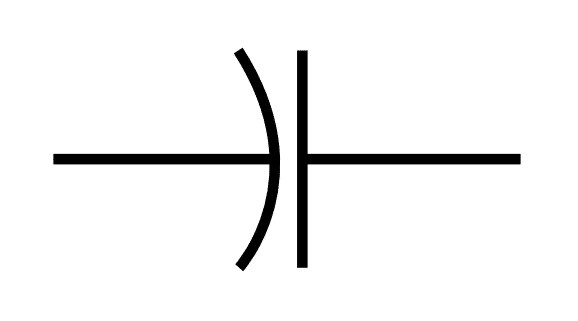

A variable capacitor (sometimes called a tuning capacitor) is a capacitor whose capacitance can be changed. The schematic symbol is like a non-polarized capacitor, but with an arrow through the middle.

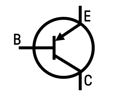

The most common type of transistor is the bipolar junction transistor  (BJT). The three terminals on the BJT transistor are base (B), collector (C), and emitter (E). A BJT transistor can either be an NPN (negative-positive-negative) or PNP (positive-negative-positive).
A schematic symbol for a BJT is a circle with three lines representing the three terminals going inside it. On the NPN transistor, the base is on the left, the collector is on top and the emitter is on the bottom. There is another line in the circle, and the three terminal lines connect to it. An arrow will go from the line in the circle and point to the emitter.
How to read a schematic
On the PNP transistor, the base remains the same, but the collector and the emitter switch places. An arrow will point from the emitter to the line inside the circle.

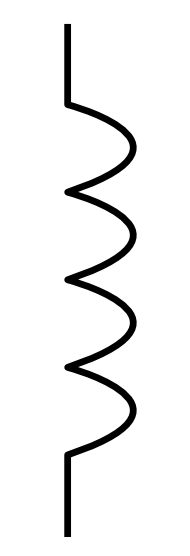

An air-core inductor has coils wound on ceramic, plastic, or other nonmagnetic forms. It doesn’t have a magnetic core made of ferromagnetic material. Inductors  are usually represented by a squiggly line or a series of curved bumps.

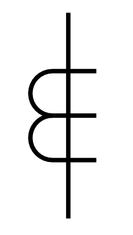

A magnetic-core inductor has a core made of magnetic material such as iron or ferrite to increase the inductance. The schematic symbol is the same as the air-core inductor, with two lines added next to the squiggly line.

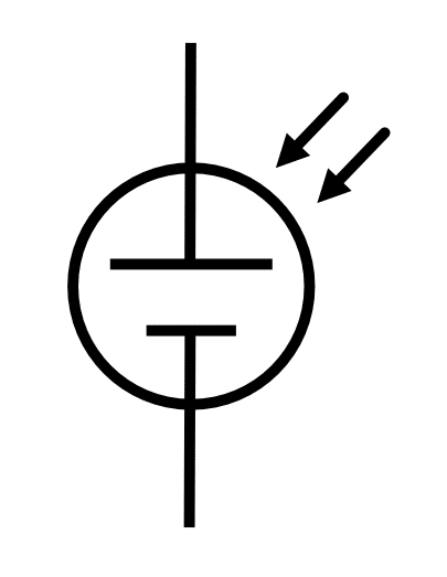

Solar cell (photovoltaic cell) battery is shown with a circled battery symbol and two arrows pointing towards it.

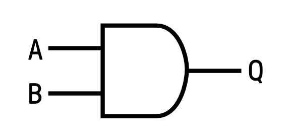

The AND gate will have an output of 1 or high only if both inputs are also 1. In any other case, the output will be 0 or low. The schematic symbol looks like the letter D. Two input lines connect to it on the straight line. The output line is in the middle of the curved line.

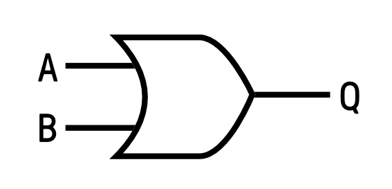

The OR gate will have an output of 1 if either or both of the inputs are also 1. The output will be 0 only if both inputs are also 0. The schematic symbol is similar to the AND gate symbol. The only difference is that the straight line in the letter D is curved.

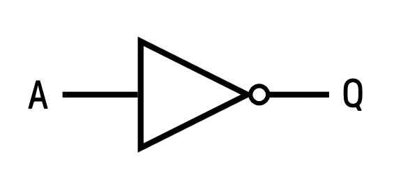

The NOT gate is a logic gate implementing logical negation. The main function of the NOT gate is to output the inverted input circuit signal. That is why you’ll often see it referred to as an inverter. Thus, if the input is 1, the output will be 0 and vice versa. The schematic symbol is a simple triangle with a line connecting to one of its sides and coming out of the tip on the other side. At the end of the tip is a little bubble that indicates the negation of the function.

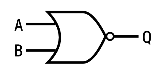

The NAND gate is short for NOT AND. As the name implies, it will be the opposite of AND gate. If both inputs are 0 or either one of them is 1, the output will be 1. If both inputs are 1, the output will be 0. The schematic symbol is almost identical to the AND gate. The only difference is the little bubble on the output line indicating inversion.

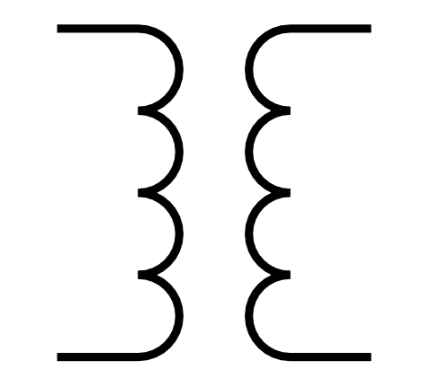

Transformers  are passive components that transfer electrical energy from one electrical circuit to one or multiple others. Electrical energy can be transmitted between coils without necessarily having a conductive connection between the circuits. One such example is the air-core transformer, designed to transfer radio-frequency currents. The schematic symbol is two squiggly lines next to each other.

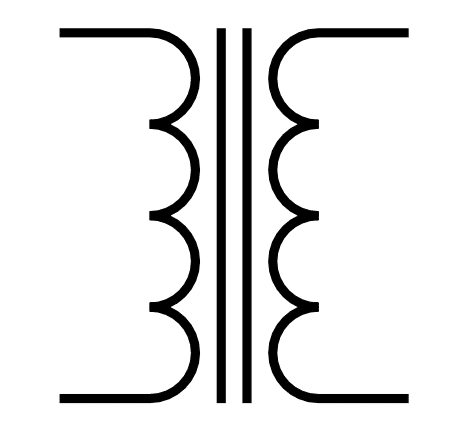

The problem with air-core transformers is that they let a lot of flux go to waste. Only a portion of the electrical energy will go from one winding to another. That is why an iron-core transformer is used. It doesn’t let flux vanish into the air. Thus more electric energy is transferred between the windings. The schematic symbol is two perpendicular lines in between the two squiggly lines.

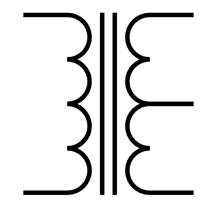

Center-tapped transformers are types of transformers with two secondary windings that are connected. They share a common connection, but each one provides a separate secondary voltage. The schematic symbol is very similar to an iron-core transformer. The only thing differentiating them is the line on the secondary winding denoting the center tap.

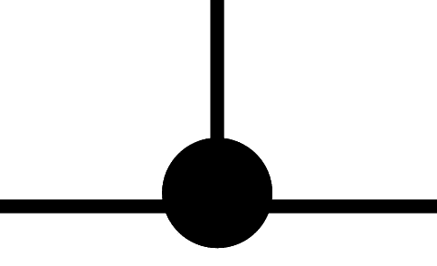

Wires are used to connect two or more terminals. Without them drawn, the schematic becomes practically useless. Wires can be either connected or not. If they are connected, a dot is added at the intersection.
There are three ways to display unconnected wires. The simplest and most common way is to leave the dots intersected. Another way is to draw a semi-circle or an arch over the point where the wires cross. Lastly, unconnected wires can be displayed with one of the wires cut off at the point of the intersection. No matter how it is displayed, you can easily remember it as no dot equals no connection.

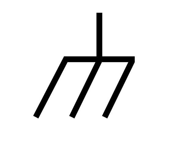

Earth ground is, as the name suggests, the earth beneath you. A rod or wires (or both) are driven into the ground. When the electric energy goes through the circuit, it will end up in the ground and disperse. The schematic symbol is three perpendicular lines, with the longest being on top and the shortest on the bottom. It indicates an arrow or triangle. Schematics can sometimes use this symbol to signify the signal ground.

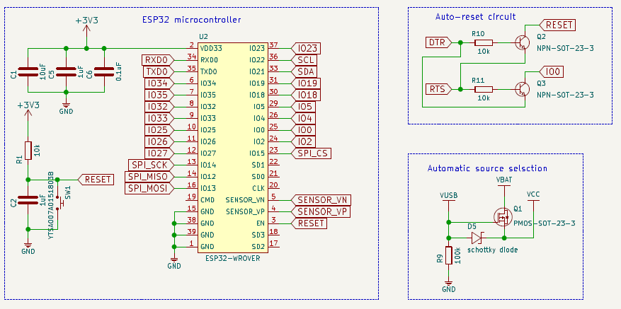

The ability to read schematics becomes essential the more you work with electronics. The more complicated a project is, the more crucial the skill becomes. It is a must-have skill when designing your PCB .
Did you know that we add the freely available schematics for all the boards we design? Now that you know how to read them, why not test that knowledge by looking at some of our schematics? Find a product that interests you (e.g. Dasduino Core), and find the schematic for it on the links to the left.
