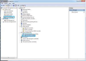

1. “Start” – (right click) on “Computer” after (left click) on “Manage”
2. That should open  “Computer management” window. We will choose “Device Manager” out of left menu, and expand “Ports (COM & LPT)” in the right menu. Then we will find COM port which presents our FTDI device. In a case which is shown in the picture below, it’s about “USB Serial Port (COM 4)”Depending on a computer, the port can be named as COM3, COM4 and so on…
3. Now, when we have successfully found driver, we need to uninstall it. Righ clicking “USB Serial Port (COM4)” will open a menu in which we’ll choose “Unistall”. After, we’ll only confirm the uninstallation.
4. All that remains is to reset our PC, to make sure that Windows successfully updated changes we’ve made.
