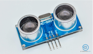

The HC-SR04 ultrasonic module uses ultrasonic waves to determine the distance of objects, just like a dolphin or a bat. Not only that it surpasses its competition with its simplicity and cost, it’s surpassing it with its technical capabilities, too. It doesn’t get confused by sunlight or black materials, such as the most famous competitor Sharp IR.
Range: 2-200 cm
Accuracy: 3 mm
Effective angle of measurement: 15 °
Voltage: 5V
The maximum quiescent current of 2 mA
Operating current: 15 mA
Ultrasonic frequency: 40 kHz
Dimensions: 45 x 20 x 15 mm

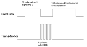

Two main parts to the underlying principle of operation of the module are the trig (switch) and echo (reflections). Microcontroller (Dasduino or Arduino) is used to send 5V on trig pin module in a duration of minimum 10 microseconds. That way we are activating the ultrasonic transducer which transmits 8 pulses of 40 kHz and waits for their reflection. When the sensor detects the reflected pulse, it sends the information back to the microcontroller via the echo pin. These data are in fact the duration of the reflected pulse, 150 micro to 25 milliseconds. If the “echo” lasts longer than 35 milliseconds, the sensor detects that the subject is out of reach.
