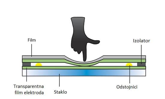

The panel contains two conductive layers that are spaced until we apply pressure and then they connect. One conductive layer is connected to the voltage and the current is constantly running through this layer. If we press the panel in that space, two conductive layers touch, the current changes, and the controller recognizes the place where the panel is pressed and sends us data. The advantage of these panels is the fact they are cheaper and simpler, but they can recognize only one pressure, and not more at the same time, and this is one of its disadvantages. Capacitive panels work differently and can recognize more pressures, and they are used on mobile phones and similar devices where we need this feature, and the resistive ones are used in simpler devices where it is not necessary to read more pressures.

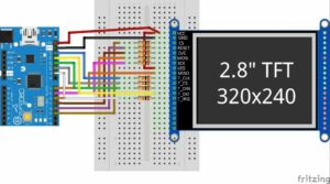

The display, as well as the touch panel, exchange data with Dasduino via SPI communication, and we need 11 Dasduino pins to connect them. Since the display and touch panel controllers work at 3.3 V, it is necessary to use 10 kOhm resistors on all data lines which are used to send data to the module when connecting Dasduino and this module. To power supply the display, we can use 5V because it has a built-in voltage regulator, but to handle the connection easily, the scheme shows how to connect everything.

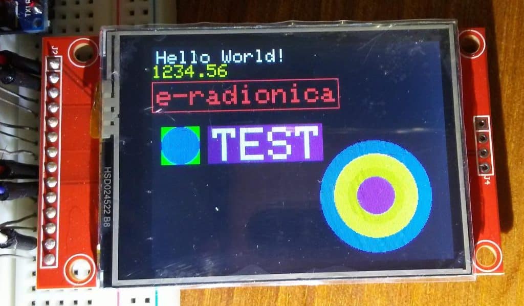

The second example of the code displays the text in several lines and draws some geometrical shapes. What is displayed and the line on the display can be seen in the following image.
