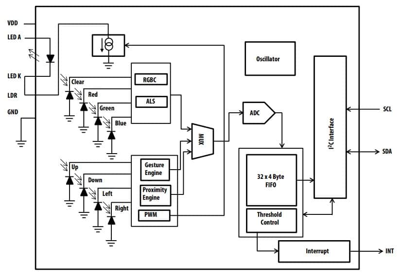

HOW DOES THE MODULE WORK?
The sensor on the module is composed of two parts: the sensor itself and the LED diode that serves to determine the proximity of an object. In the sensor, there are four photodiodes which serve to detect gestures (they are set up in a way to successfully detect hand motion in different directions) and four photodiodes that serve to detect the color and intensity of light.

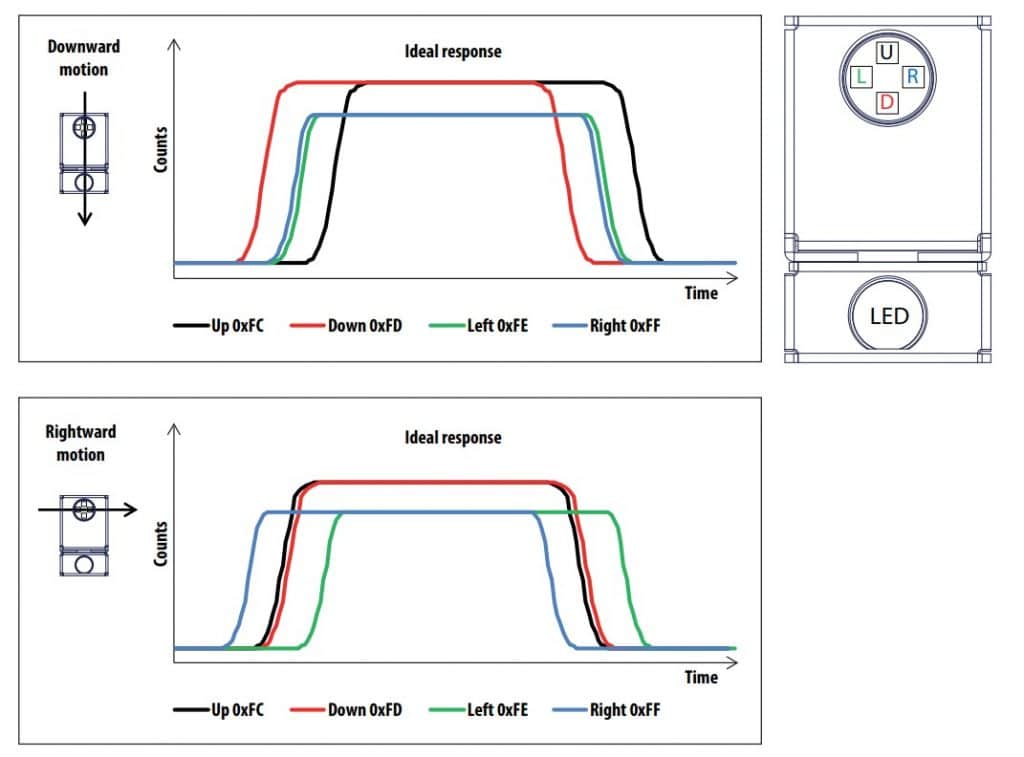

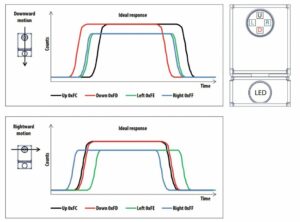

Each of these four color photodiodes measures the intensity of light of a specific wavelenght ranges, so that we have a photodiode for red, green and blue color which is done in a way that  there is a certain color filter in front of the photodiode. The last photodiode is clear, it only contains infrared and UV filter, and it detects the entire range of colors that photodiodes for red, green and blue detect together. It serves to determine the intensity of light coming to the sensor. In the image below, it is visible which range of colors does the individual photodiode detect.
Gesture detection is based on the observation of the amount of light intensity, provided by the infrared diode which is embedded in the sensor, that reflects back to photodiodes for gesture detection. In the image below, it is visible how a certain gesture is detected. U, L, D, R represent photodiodes for gesture detection. If the proximity of an object is detected first, on the D photodiode, then on the L and R and with a similar count (intensity), and in the end on U diode, it would mean that the downward movement has occured.
Gesture detection code can be adjusted in a way that the change on the INT pin occurs while detecting gestures, but also the same can be enabled for detecting an obstacle (object), and in that case, the sensor would inform us about it via INT pin. This allows making a quick and important operation in the code using interrupts.
