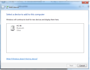

If we have not connected BT under the Bluetooth devices before, we will not find anything. So, let’s connect to a new device by clicking on Add a Device.
This will open a dialogue for adding a new BT device. Now we wait for it to find the device, signify HC-06 and click on Next.

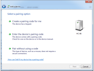

In the next window, choose Pair without using the code.
If the system requires a code, enter 1234 and that is it. NOTE: some systems will later require a permission for connecting. In that case, a pop-up window will appear and using it, we will allow the connecting with the specified code.

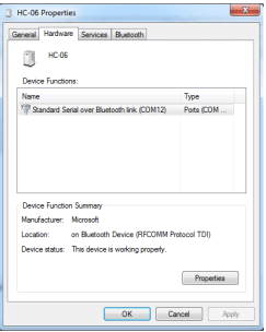

Now you should see the HC-06 device in the BT devices list. Right-click on the device, select Properties, and the Hardware tabOn it, you will find a virtual port which is assigned to the device. The example in the picture below is the COM12 port. The same can be found on the Services tab.
