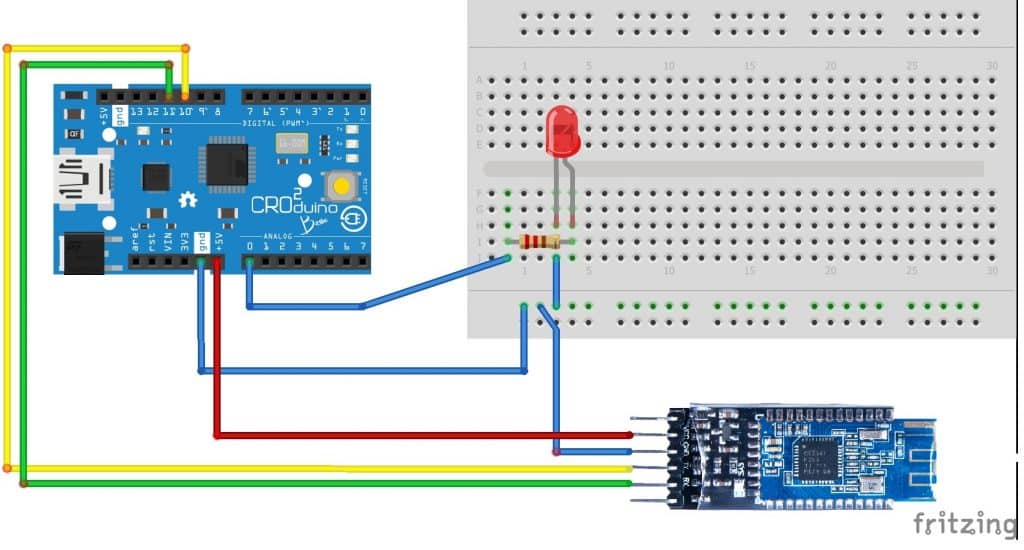

Now, we will demonstrate a very simple Dasduino and HM – 10 switch that will turn the LED diode on or off via cell phone. For this switch, we will need Bluetooth HM – 10, Dasduino, LED diode, few wires for connecting and of course, the cell phone.
VCC HM – 10 is connected to 5v or 3.3v of the Dasduino, GND to GND, RXD is connected to Croduino’s digital pin 11, and TXD to digital pin 10.
In order to be able to control the switch, we will need a device that we will use to control it, e.g. a cell phone. We will need an application for controlling the Bluetooth device via cell phone, in this example, we will use the Serial Bluetooth Terminal application that can be downloaded via google play store for Android.
If you have successfully connected and copied the code, when you connect to your mobile device, you should receive the message “Bluetooth connection is on” at the terminal of the application.
With the “on” command, you will illuminate the LED diode built on Dasduino and the breadboard, and receive a message “It is on!”, and with the “off” command you will turn them off to get the message “It’s off!“.
