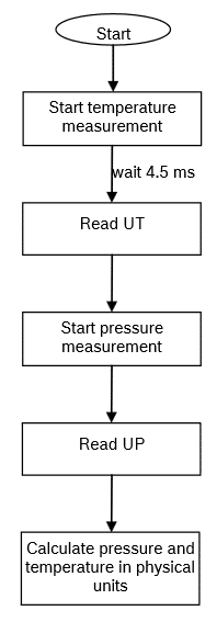

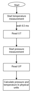

One measurement procedure is the following:
Microcontroller sends a series of commands to trigger the measurement of pressure and temperature. After the ADC conversion we get uncompressed values: UP – uncompensated pressure and UT – uncompensated temperature. This data can be read through I2C interface, however, for the calculation of temperature in degrees and pressure in hectopascals, calibration is required. The calibration constants are read from the EEPROM memory, and they are also read through the I2C and finally we get the data that means something to us.
Sampling can be of maximum 128 times per second, and in that case only one temperature measurement is recommended.

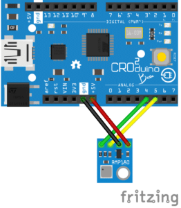

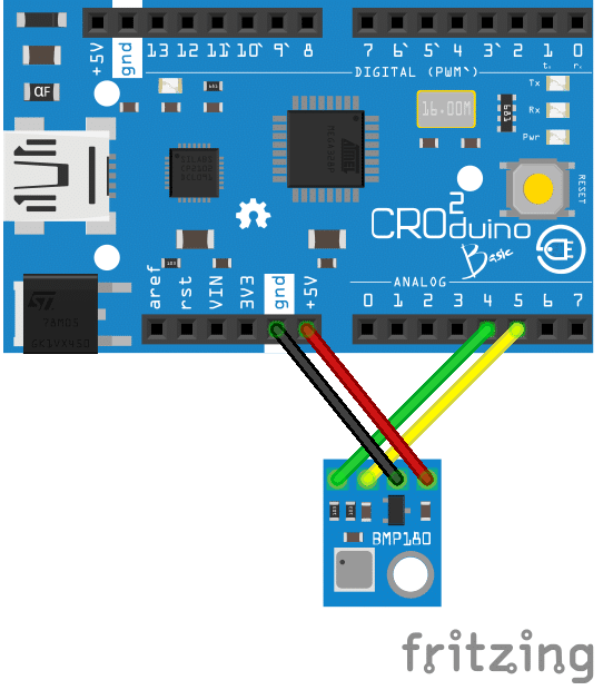

HOW TO CONNECT MODULE?
For those who have skipped this section, BMP180 uses the I2C interface. Breakout has everything necessary for that type of communication and the regulator, so the input voltage can vary from 2-6 VDC. That is, it practically does not matter if we connect it to 3V3 or 5V Dasduino’s pin.

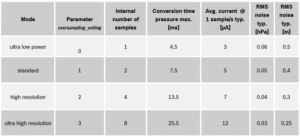

Bosch’s engineers have predefined something they named oversampling_settings, and the speed and accuracy of the readings and electricity consumption depend on it. There are 4 options possible and the parameters are shown in the table below. The parameter 3 or ultra high resolution is used in the code.
