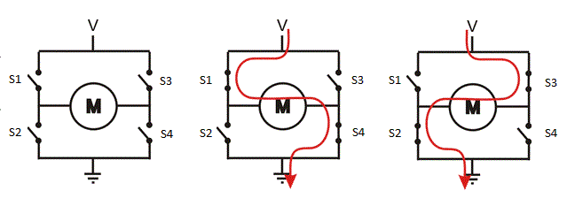

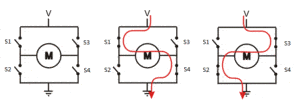

L298N driver for motor uses the so-called H-bridge integrated chip. H-bridge is a circuit which consists of 4 switches connected to the motor in a way shown in the image below. If we close S2 and S3 switches, and open S1 and S4, the current will flow in a certain direction. If we shift states of switches so that the S2 and S3 are open, and S1 and S4 closed, the current will flow through the motor in the opposite direction. Besides, we must not close all four switches at once or both switches on one side of the H-bridge (e.g. S1 and S2) because it would induce a short circuit.
The table below shows every possible combination of switch states and their outcome.
With the H-bridge, it is very easy to shift polarity on the load. Most commonly, they are used for changing DC motor’s rotation directions. The H-bridge is also used in other applications such as DC/AC, AC/AC or DC/DC converters. The L298N driver is designed for motors but can be used for other devices which require a shift of polarities on their outputs, for certain uses. With the possibility of shifting polarities, L298N driver has the capacity to control the motor’s rotation speed using PWM (eng. Puls-Width Modulation) signal. We must note that L298N driver also contains two outputs which can be used to control the operation of two motors.

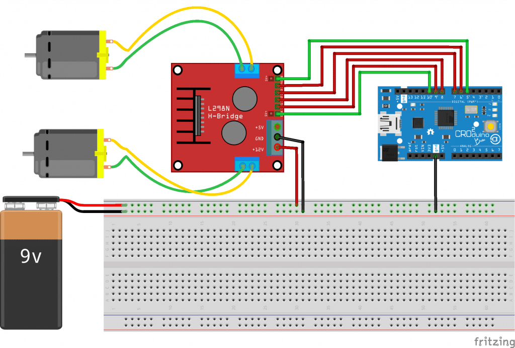

HOW TO CONNECT IT TO DASDUINO?

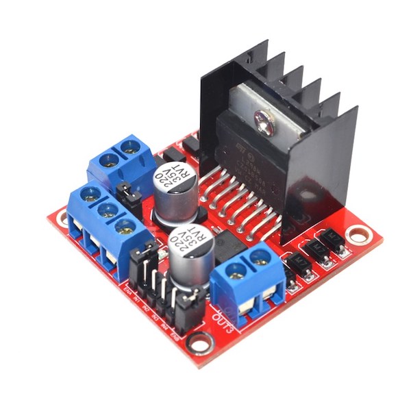

L298N driver contains several connectors that are listed and explained below:
OUT1 – +/- Output for the motor A
OUT2 – +/- Output for the motor A
OUT3 – +/- Output for the motor B
OUT4 – +/- Output for the motor B
CON5 – Serves to activate a 5V voltage regulator. It is turned on by setting up the jumper (if the input voltage is less than 12V).
EnA – Serves to control PWM for the motor A (it is necessary to place the jumper if we want to control motor rotation speed)
EnB – Serves to control PWM for the motor B (it is necessary to place the jumper if we want to control motor rotation speed)
In1 – Serves for controlling motor A rotation direction
In2 – Serves for controlling motor A rotation direction
In3 – Serves for controlling motor B rotation direction
In4v – Serves for controlling motor B rotation direction
+5V – The input where an external power supply 5V source is placed (if the jumper is not set onto the CON5). The output provides 5V (if the jumper is placed on the CON5).
GND – Ground. It is necessary to connect all circuit’s minuses with this GND
+12V – The input of the external power supply for motors. You must remove the jumper on CON5 if voltage is greater than 12V. Max 35V DC.
ARDUINO CODE
For controlling motors using L298N drivers, it is not necessary to use any library. We run the motors by turning the output on/off using digitalWrite() function. For motor rotation speed, we use analogWrite() function.
