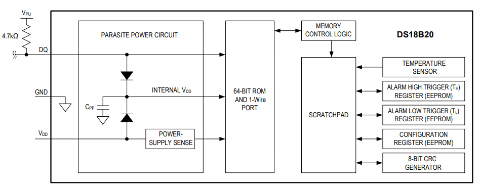

If we look at the datasheet of this device, we will notice a block diagram that seems somewhat more complicated than that of other temperature sensors, and that is because of additional functionalities.
The device may have a special external power supply or it can be supplied via parasitic power using data line, about which you can find more in a separate tutorial.
Since we have several devices our microcontroller can communicate with on the same data line, there must be a way to ensure that only one device “speaks” in each moment. In order to ensure reliable communication, we use One-Wire protocol because of which all devices that use it have a unique 64bit address, using which we address a certain device on the bus.
Measurement precision can be set to 9, 10, 11 or 12 bits. This value will be adjusted according to what is more important to you, faster temperature reading or precision. For example, if we choose 12bits we will get a maximum precision, but the slowest reading time, up to 750 milliseconds.
In the block diagram, we can still notice two registers scheduled for alarms, into which the temperature value is entered. One register is for the lower limit, and the other for upper. This feature is used in the realization of protective functions. For example, if you want to protect a device from overheating to the upper limit register, you will enter the maximum temperature of a device you are protecting. If the device exceeds the specified temperature, this thermometer wil generate an alarm that the microcontroller detects and takes certain measures.
When the microcontroller gives a temperature reading command, the thermometer goes from idle state and starts the measurement. By the end of measuring the temperature is saved to memory (Scratchpad) and the thermometer goes into sleep mode in order to reduce energy consumption.

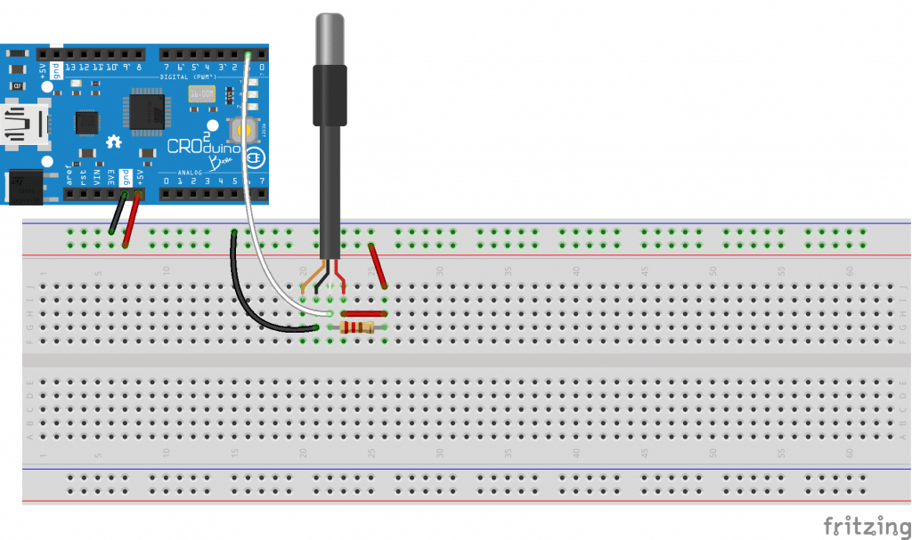

Connecting is very simple since we only need to connect three wires and one 4,7kΩ resistor. The red wire of the thermometer is connected to Dasduino’s +5V power supply, and the black wire to the GND. The data wire can be connected to any digital pin. Between the data wire and +5V it is necessary to connect a pull up resistor. We have chosen digital pin 1 in this example, which we will later on use in the program code. The connection scheme is shown in the following picture.
