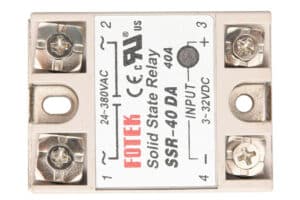

On the relay, we can see the four terminals labeled with 1, 2, 3 and 4. To the first two (1 and 2) we connect the load of higher power we want to control, and to the other two (3 and 4), we connect a microcontroller (input). The input signal (input) of the relay should be 3 to 32 V (DC), which means that the relay will turn on if the voltage between the plus and the minus is within that range. Usually, the minus binds to GND, and we give a positive voltage to the plus. Also, there is a red LED on the relay that visually displays the status of the relay (it lights up when it is on). The basic component of this relay is the so-called TRIAC. A TRIAC is a semiconductor component that has the ability to control alternating current. It will conduct when the control electrode is induced, and stopped when the control electrode is turned off and the current flowing through the TRIAC falls below a certain level.

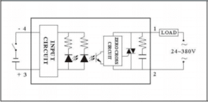

The solid state of the relay includes some additional components that control the TRIAC and add some security measures. Let’s see how the inside of a Fotek SS relay looks like:
From this scheme, we see that the control side is optically isolated from the output side, so the combination of controlling the relay with a microcontroller is safe. When we give the excitation signal to the control side, a LED within the optical insulator will light up and trigger the control side of the TRIAC. On the control side of the TRIAC, there is also a circuit that detects the zero point of the AC voltage,
which means that if we want to turn the relay on at some point in time, the switch will first have to wait for input voltage to drop to 0V and then turn the relay on. This greatly reduces the appearance of electromagnetic interference, because by switching the relay on at some point in the period where the voltage is closer to the maximum value, sudden voltage spike occurs, which means high frequencies.
Next to the TRIAC, we see two additional components, a resistor and a capacitor. They are here to ensure the correct operation of the TRIAC in case we want to control the inductive loads and this branch is called a snubber circuit. When the inductive load is switched off, short high-voltage impulses may occur due to self-induction of the coil, and such an impulse may cause a random ignition of the TRIAC, or some unpredictable phenomena in the circuit. A snubber provides an additional route by which the current can “move around” the TRIAC and thus prevent a sudden ignition.
