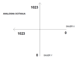

The module itself has two potentiometers which move depending on how we move the analog stick on the joystick. One of them is connected to the x axis, and the other to y. Let’s take the x axis as an example: if we move the analog stick completely to the left, the potentiometer will provide readings closer to the ground. If we move it to the right, the reading will be closer to the voltage to which we have connected the module. Of course, readings themselves are analog (we get the value from 0-1023) and it is possible to precisely determine the stick’s position. The push button works on a principle of sending HIGH (1) when it is inactive and LOW (0) when it is active. This means that the push button has a built-in pull-up resistor.
What generates analog values are two potentiometers below the part where joystick’s analog stick is located. Current flows through both of them, and the output voltage will depend on the amount of resistance given by potentiometers. Resistance decreases or increases depending on the position of joystick. By observing both potentiometers, this joystick can determine the exact angle under which it is located.
