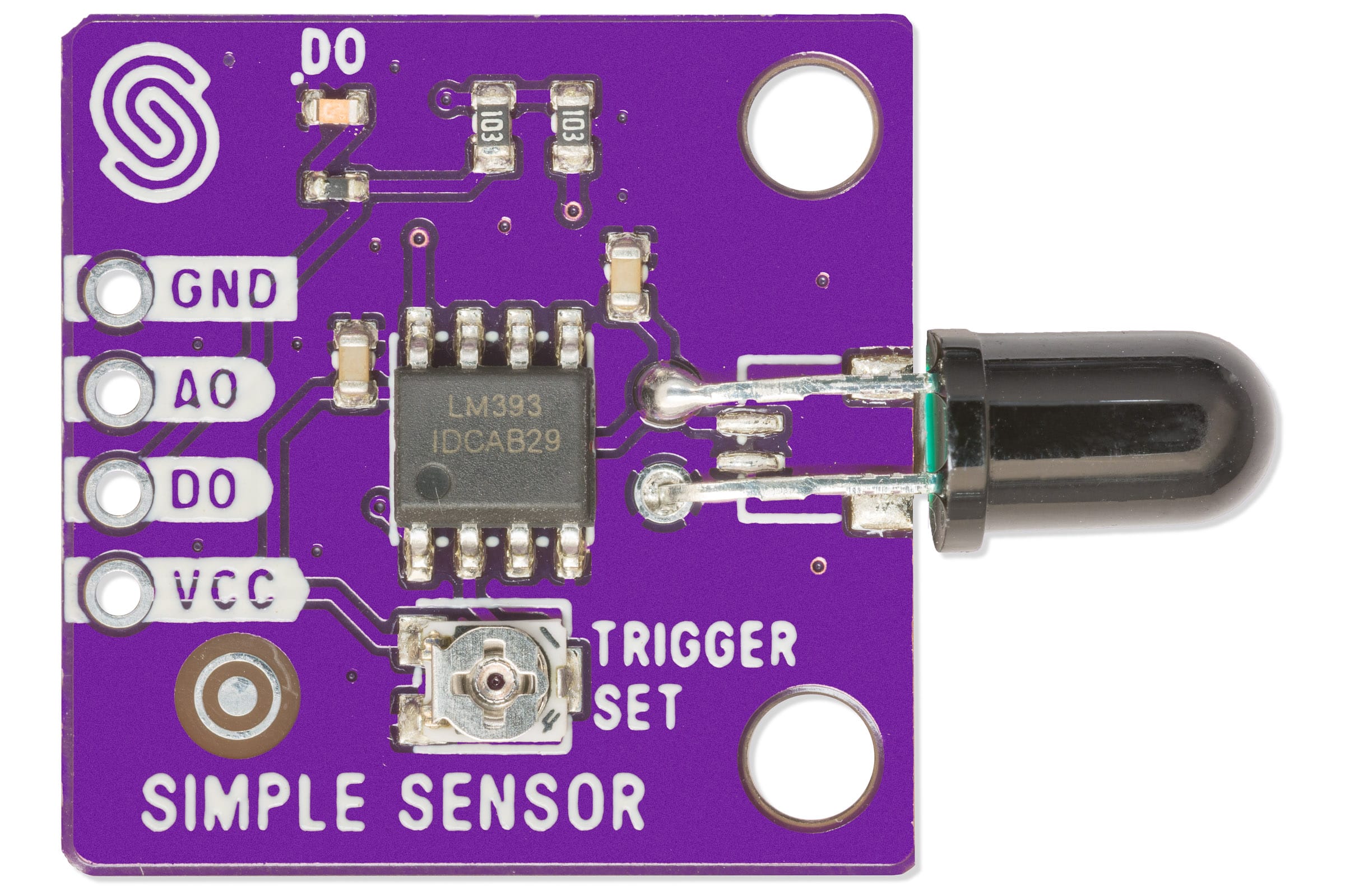

Fire detector (phototransistor)
The fire detector is a phototransistor which, because of its dark lense, detects infrared light. Infrared light is emitted by the sun, but also the fire, and that is why this sensor is suitable for fire detecting. The sensor is activated when it is near the source that emits infrared radiation and the stronger the radiation, the smaller the value on the analog output. The digital output has 5V (logical 1) when there is no radiation, and when the radiation increases at the adjusted value (the value at which the output state changes is adjusted by the potentiometer) the digital output turns from logical 1 to logical 0.

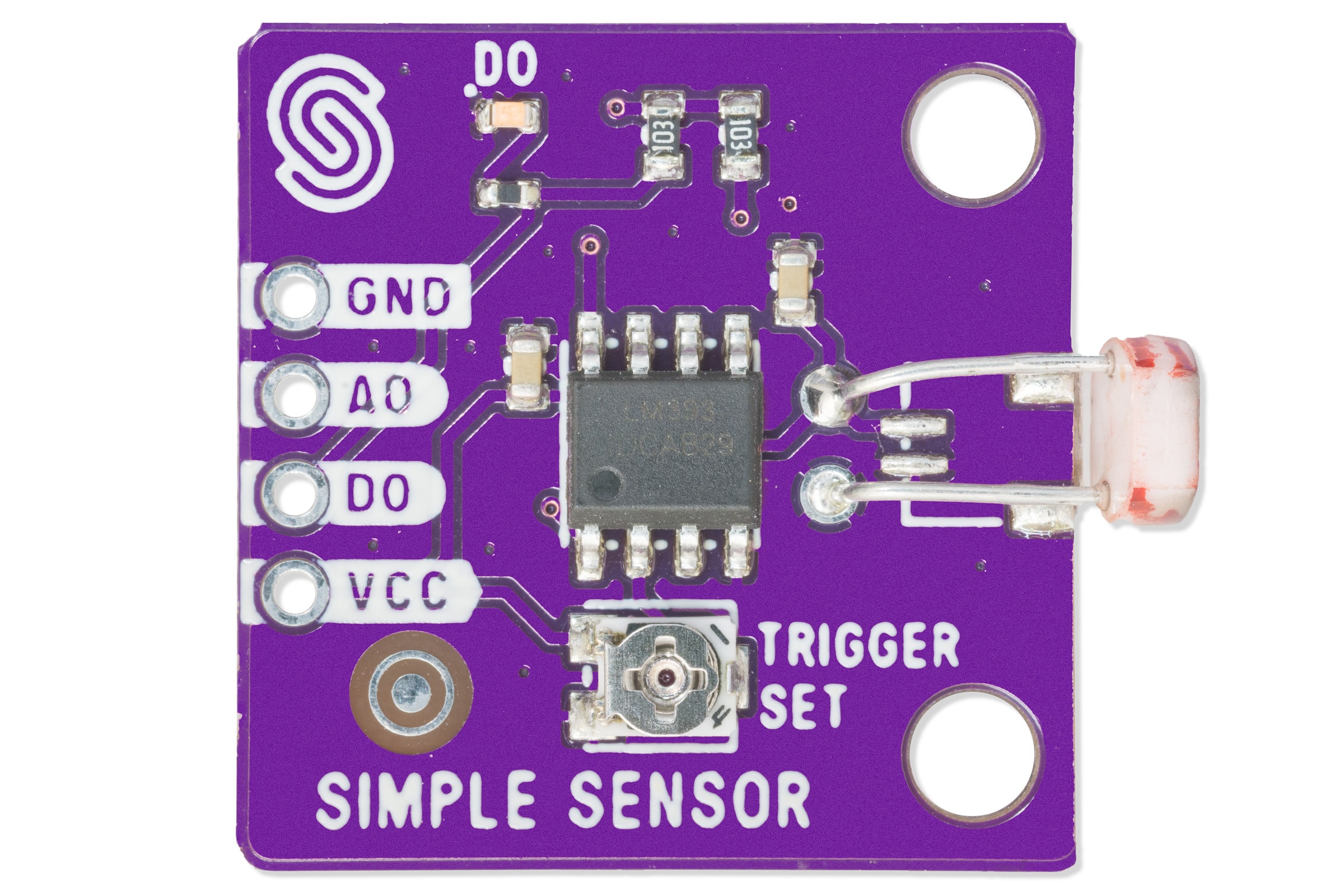

Light sensor
The light sensor is a photoresistor that changes the resistance value depending on the intensity of light. When a photoresistor is connected to our breakout, we get a sensor to measure the amount of light, and at the output, we get a voltage that is proportional to the intensity of light. On this sensor, we can use the digital output to turn on the light by adjusting the light level at which the digital output is activated. The sensor provides a higher voltage on the analog output when it is dark, and lower when it is illuminated.

The sensors are connected either from the A0 output to the analog pin of the Dasduino if we want to read analog values or we can connect the digital output (D0) from the sensor to any other digital pin on the Dasduino and read only when the pin turns from logical 0 to logical 1 and vice versa, and the value at which it happens must be adjusted using the potentiometer on the board. Sometimes it is enough to read the transition between two states in the project, and sometimes we need the analog value to be able to, depending on that value, do some things (we can have more than 2 states) and according to that we must choose which output will be used, or we can use both outputs. To the board, we still must connect +5V and the GND and we can finally read the values from the sensor.
