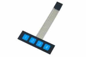

It is about a membrane keypad that consists of 4 keypads and it is very easy-to-use, and in smaller projects, it is quite sufficient. The keyboard has 4 keypads in one row and works on the same principle as the 4×4 membrane keyboard, but it is smaller and more convenient to use where it is not necessary to have 16 keypads.
Sensor characteristics:
  • Upper part size: 7 x 2cm
  • Cable length: 9cm, flexible
  • Connector: 5-pin

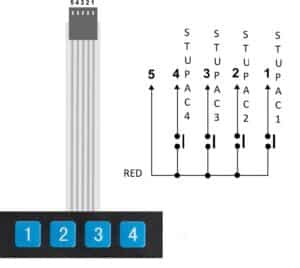

This keyboard uses 4 keypads with one end connected to the row and the other end to the column. Since we have one keypad in each column, we simply have each keypad connected to one output pin. Keypads simply connect one pin to another, i.e. in our case, they connect the row and column in which they are located, as you can see in the image below.

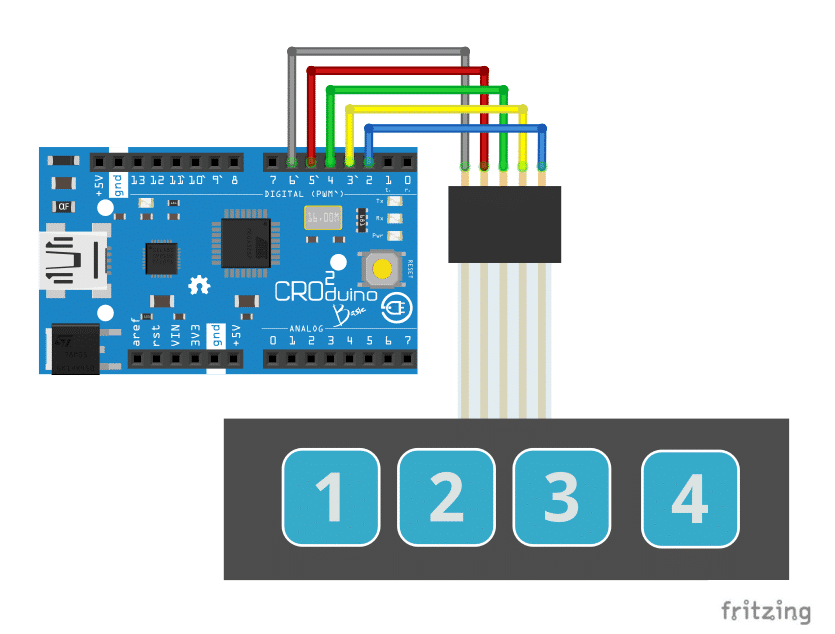

The keyboard can be easily connected to Dasduino because on the keyboard, we have female headers, just like on Dasduino, so we can use male to male cables. The keyboard is connected serially to Dasduino’s digital pins, and the image above shows which pin is which on the keyboard so that we could adjust the given connection scheme to our own projects.
