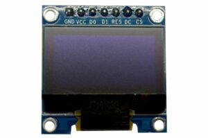

In this tutorial, we will get acquainted with a very small, but an interesting module that finds its application in all the projects where it is necessary to show some data from the sensor. It is about an OLED 0.96“ display, whose size makes it easily applicable in every project because it does not take up too much space and it provides an excellent contrast due to the different work principle than that of the LCD display.

The display consists of 128 * 64 individual pixels that are controlled by the SSD1306 controller that turns each pixel on or off, depending on how we set it. As we have the pixels that turn on or off, they provide lighting and the display does not require backlighting like the LCD display, so the consumption of the OLED display is much lower than that of the LCD. For the same reason, the contrast is much better and you can clearly read even smaller characters from the display, despite the display’s small dimensions. The SSD1306 controller can receive data in 2 ways: via SPI or I2C communication, depending on how we choose. On the back of the display, it is indicated which pins we need to connect briefly in order to have SPI or I2C communication. For the controller’s power supply, we use a 3.3V voltage and that is why a voltage regulator is implemented on the board. The controller can also generate the voltage it uses for power supply (7-9V) to the voltage necessary for power supplying the display itself, i.e. pixels. Since our module is calibrated to a 5-3.3V power supply, we have to make the controller produce a higher voltage for the display to work, in the program.

The module is connected easily because it uses I2C or SPI communication. If we use I2C communication, to the A4 pin we connect the SDA (D1) module pin, and to the pin A5 on the Dasduino, we connect the SCL (D0) module pin. If we use SPI communication, we need 5 communication conductors, and below, it is written which Dasduino pin is connected to which pin on the display. As indicated in the characteristics, the module can operate at 5 V or 3.3 V, so it does not matter which voltage we deliver to it, because it has a built-in voltage converter.
SPI komunikacija
Display >>>>>>>>>>>> Dasduino
GND >>>>>>>>>>>> GND
VCC >>>>>>>>>>>> 5 V or 3.3 V
D0 >>>>>>>>>>>> D10
D1 >>>>>>>>>>>> D9
RES >>>>>>>>>>>> D13
DC >>>>>>>>>>>>D11
CS >>>>>>>>>>>> D12
