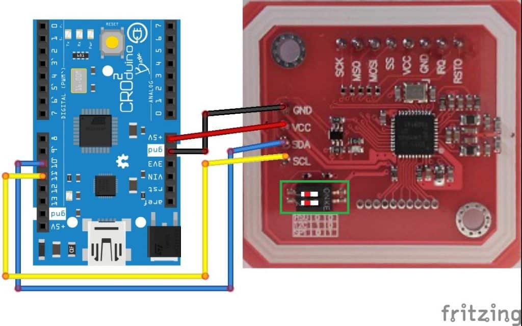

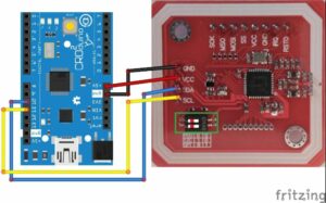

HSU (HIGH-SPEED UART)
The module is adjusted for HSU communication (both switches should be in position 0), so we will make the first example with this type of communication between the module and Dasduino. We connect the module according to the scheme and transfer the given code to Dasduino, so we should be able to read the UID code from the card or tag depending on what we are using.

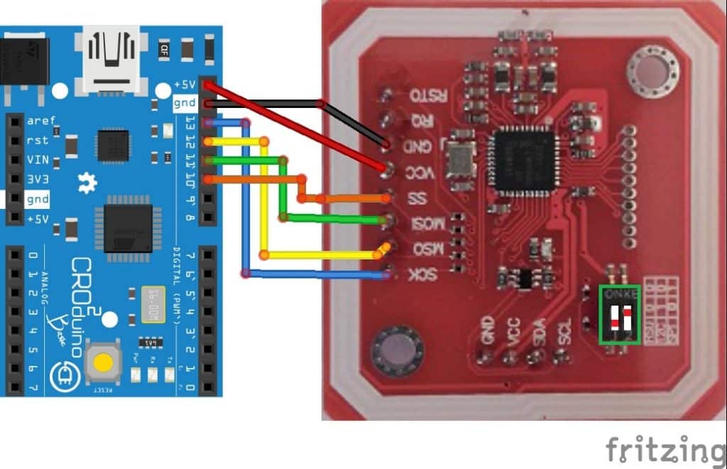

SPI COMMUNICATION
As we already know, for SPI communication we need 4 lines + 2 more for the power supply, but despite having more lines, this communication has a higher baud rate than the I2C and HSU communication. In order for the module to know how to use SPI, it is necessary to leave the first switch in position 0, and move the second to position 1, which is shown in the previous part of the tutorial. In the wiring scheme, it is shown how to connect the module to the microcontroller and which pins we need. After connecting the module to Dasduino, according to the given scheme, it is necessary to transfer the code example for SPI communication to the Dasduino board. Just like the previous code, this one only allows reading the UID code from cards or tags.

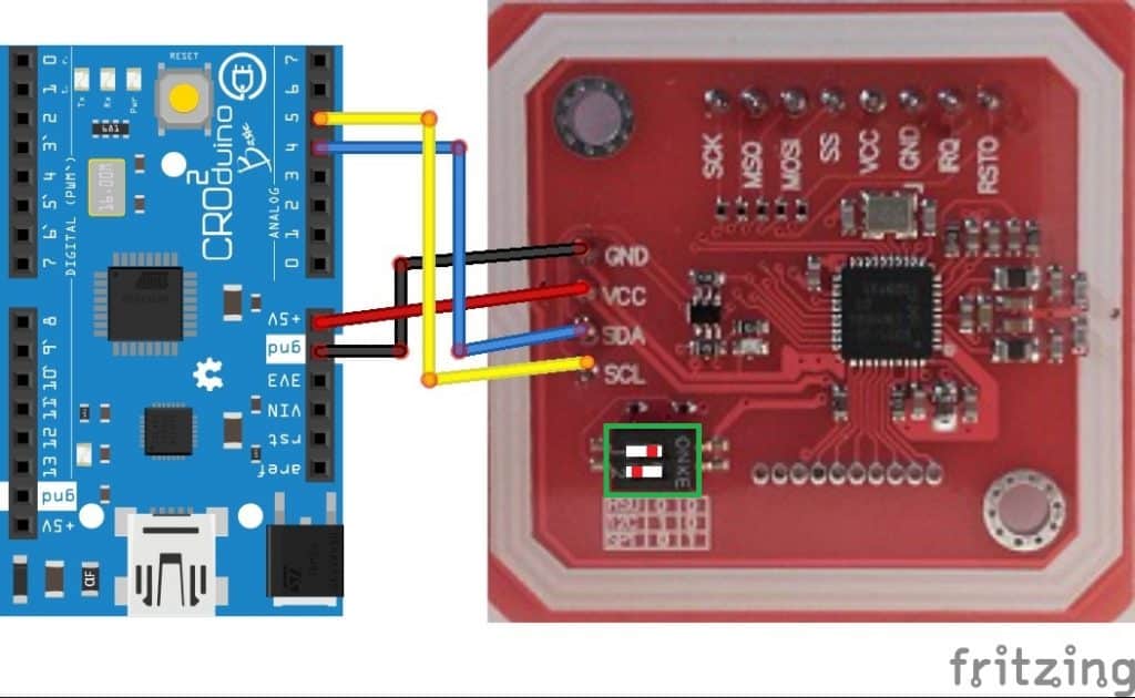

I2C COMMUNICATION
I2C communication is slightly easier to connect and use, and we will use it in the following examples. Below is the image of the wiring scheme, as well as the layout of switches for this type of communication.
As we saw earlier, NFC differs from RFID in the fact that, in addition to reading the UID code from cards, it allows reading and writing messages on a card or tag. First of all, let us explain how, in order for us to be able to write a message on it, the card must be of a certain format. That format is NDEF, and since the cards are not pre-formatted, we must first do the formatting so that we can write on the cards.
To format the card, you simply need to transfer the card formatting code (tag) to Dasduino and place the card on the PN532 module, and a message that the card is formatted will be displayed on the Serial monitor. If the card has already been formatted, a message stating that the formatting failed is displayed.
