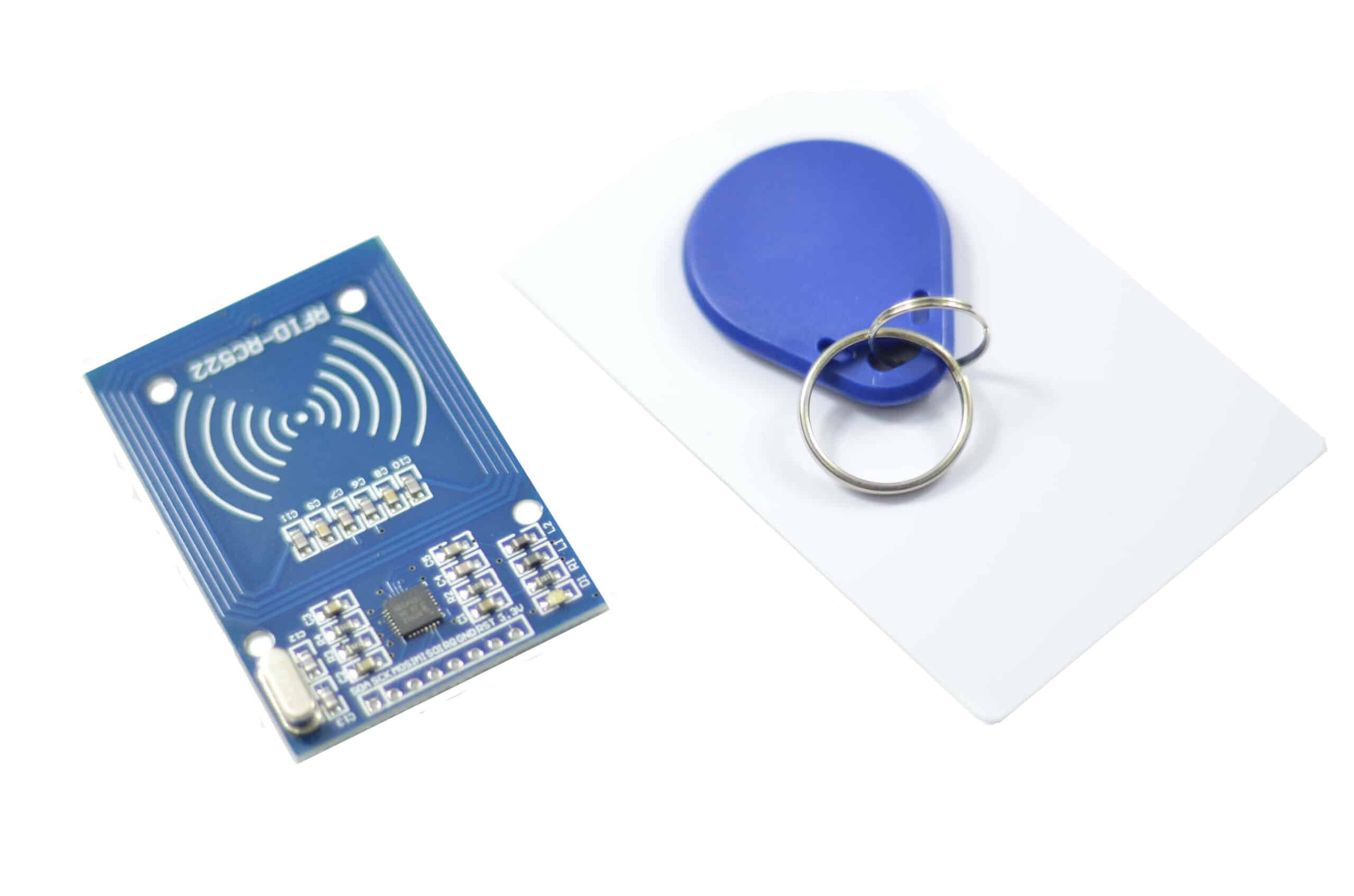

In this tutorial, we will introduce you to another technology that allows wireless data transfer. Although it is used at very short distances, it has its role in many parts of modern life due to its reliability and resistance to malfunction. From tracking goods in transport, all the way to controlling access to facilities.
• 13.56 MHz RFID technology
• IC : Philips MF RC522
• Voltage : 3.3V
• Current : 10mA(idle), 26mA(active)
• Reading distance from the sensor : <5cm (with tags that come with this reader)
• Comes with a passive RFID card and an appendage
• Comes with flat and bent headers, unsoldered.

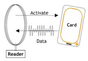

HOW DOES IT WORK?
MFRC522 is an integrated IC for contactless communication at 13.56 MHz. This chip controls the antenna designed for reading and sending data. The base station, i.e. RFID reader consists of an antenna, an RF module and a control unit. RFID tags and cards have a similar construction, but without active components, which means they do not contain any batteries or power supplies. They only consist of an antenna and a microchip.
The communication takes place as follows. The base station (antenna) constantly emits electromagnetic waves. When the RFID card or tag approaches the base at a distance of about 10 cm, the voltage on the receiving antenna. which serves as a power supply for the built-in microchip, will be induced under the influence of an electromagnetic field. Now that the card or tag have the energy necessary for normal operation, the built-in chips manipulate the load so that the base station can read a series of ones and zeros.

Simply connect the module with your Dasduino via SPI communication. RST and SS can be changed in the code according to your needs. It is necessary to note that the module operates at 3,3V. Also, add a resistors of smaller values (e.g. 470 Ohm) to the LEDs and watch out for the polarity!
RST ====> 9
SDA(SS) ====> 10
MOSI ====> 11
MISO ====> 12
SCK ====> 13
Vcc ====> +3V3
GND ====> GND
red LED ====> 8
green LED ====> 7
