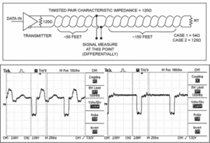

Termination resistors: when sending bits from one end of the cable to another, there is always a reflection of the voltage that returns along the cable and is larger when the raising edge is steeper (sharper) and when the transmission lines are longer. This negatively affects communication, and for such a phenomenon to be reduced, resistors between lines A and B are used. Their value should be equal to the characteristic impedance of the lines (typically 120 Ohms per pair).
The image that shows signals with non-adapted (left) and adapted resistance (right)

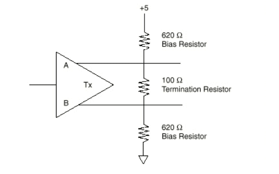

Bias resistors: With the RS485 networks, it may happen that at one time none of the devices send data. Then, the differential distinction between the transmission lines is 0V and this is an indefinite state for the receivers. Such a condition may cause inaccurate data in the receiver due to the noise collected on the transmission lines, and for that purpose, resistors are used to set the signal lines to the proper voltage in the voltage configuration of the divider.
Arrangement of bias and termination resistors at the ends of the wires

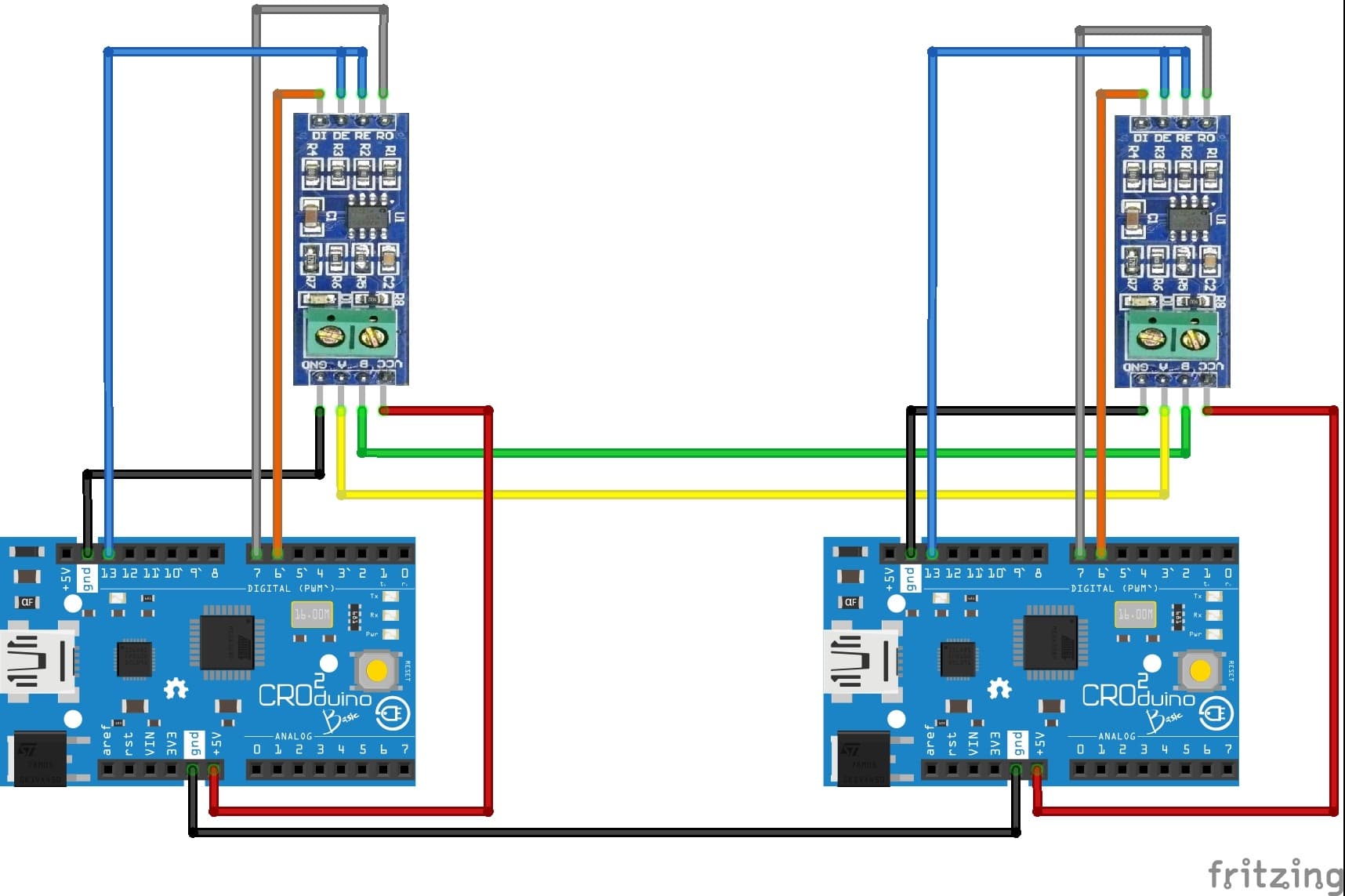

HOW TO CONNECT IT?
GND ————> GND
Vcc ————-> +5 V
RO ————-> Pin 7
RE ————> Pin 13
DE ————> Pin 13
DI ————> Pin 6
A ————> A
B ————> B
