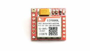

In this tutorial, we will describe the GSM/GPRS module SIM800L, which is used to make and receive calls, messages and connect to the Internet through the GSM network. The module provides numerous possibilities because using it, we can set up projects connected to the Internet anywhere, without being dependent on home ADSL Internet or WiFi network. Within the tutorial, we will briefly describe how the module works and describe the process of making calls, sending messages, and connecting to the Internet.
HOW DOES IT WORK?
This module uses GSM technology and it connects to the Internet, sends messages or makes calls using that same technology. GSM is a network technology mostly used for mobile communication. Within the GSM network, there are several units that enable communication jointly: the mobile station (our GSM module or mobile phone), the base station subsystem, and the network subsystem. The mobile station (MS) consists of a GSM device and a card known as the SIM card. The SIM card is device-independent, which means that the SIM cardholders can use GSM services on any device using their SIM card. It contains an IMSI number that identifies the user to the system. The mobile station connects to the nearest base station (transceiver) and exchanges data with it. The base station subsystem consists of a base transceiver station and a base station control section, but it also contains transceivers that are connected to mobile stations. The network subsystem contains a mobile service switching center that works like a regular switching node and registers users, authenticates, directs calls, etc. This system consists of several units that perform all the necessary functions and further connect to a fixed telephone network.
Our module is a mobile station that contains a SIM card and takes care of connecting to the base station, while it communicates with Dasduino via serial communication and uses the AT commands using which we control the module.

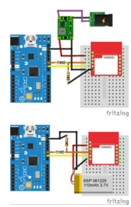

HOW TO CONNECT IT?
The module uses only 2 pins as it communicates via serial communication. Since we use serial communication and pins 0 and 1 to communicate with our computer and to program our microcontroller, we need to use the SoftwareSerial library and the pins we define ourselves to communicate with our GSM module. To power the module, we must use an external power supply because Dasduino cannot deliver the amount of current required by the module. The module can max up to 2A of current while connecting to the Internet, so we need to use the power supply that can provide as much current. For the power supply, we must make sure that the voltage does not exceed the value of 4.4 V and that it is not below 3.7 V, and to achieve this, we can use a step-down converter which we will adjust to 4.2 V. We can power supply the module using the LI-po battery whose rated voltage is 3.7V and the maximum voltage of a fully charged battery is 4.2V which is below the maximum module voltage. The scheme that uses the battery for power supply and the scheme that uses the source with a step-down converter is shown in the images below. The serial communication pins used in the schematics and in the example code are 9 for the RX line and 10 for the TX. Since the module is not 5V tolerant, the RX line is connected via a voltage divider, which is made up of 10 kOhm resistance and 5.6 kOhm.
