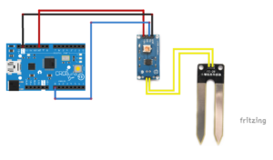

In the following example, we will use a pin on the analog sensor that will provide values between 0 and 1023 depending on the humidity of the soil. Connect GND to Dasduino’s GND, + 5V to the digital pin 10 and connect the analog output of the sensor to the A0 pin on the Dasduino. Finally, we just need to connect the “fork” to the bottom two pins of the module according to the image below.
