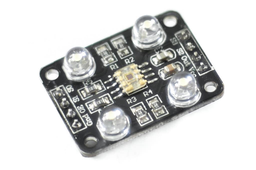

TCS230 combines photodiodes and voltage-to-frequency converter. It contains an 8×8 series of photodiodes: 16 with blue, 16 with green, 16 with red filter and 16 without filter. If you take a magnifying glass and target the center of the chip, you will be able to see these filters. The sizes are 120x120um, and they serve to filter “random” radiation. On the module are 4 wide-angle 5mm cold white LED diodes in order to increase radiation and other passive components necessary for direct reading of the output pin.
