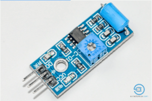

Vibration sensor module is a breakout module for the SW-420 vibration sensor with the LM393 comparator. Except for vibration detectors, we find it in anti-theft devices.

The main part of the module is a vibration sensor SW-420. These sensors usually have a little ball inside. When it moves, the “impacts” are detected on the edges and in all directions thanks to the roller shaped housing. The module itself has two signaling LEDs: the red one is a power LED, and the green one is activated while detecting vibrations or titrations. When there is no detected vibration the output module logic is LOW and vice versa.
On the module, there is also LM393 analog voltage comparator which functions as a small voltmeter with integrated switches. It measures voltage in two different points and compares the difference. If the voltage in the first point is higher than that of the second one, the switch is on. In reverse, the switch is off. The comparison voltage is adjusted using built-in potentiometer on the module, using which we decide when the module will send LOW signal via digital output pin. This allows us to use module even without logic controllers.
