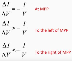

This technique uses voltage and current derivations (changes) to determine whether to increase the voltage or decrease it to reach maximum panel power. First, we measure the voltage and current and determine their change (derivation) by subtracting the previously measured value from the current value.
When we divide the change in current by the change in voltage, we get conductivity. The image shows when the operating point is left or right from the maximum power point. If the change in current divided by the change in voltage equals the negative value of the current divided by the voltage, then we are at the point of maximum power.
