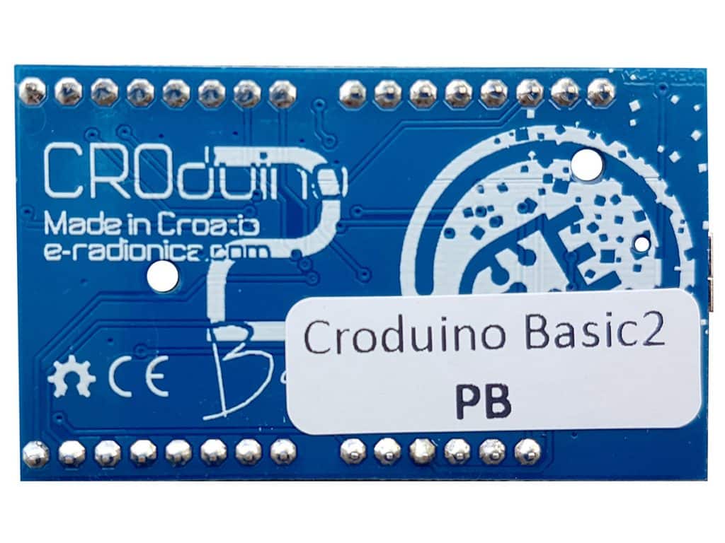

Your CroduinoBasic2 has arrived and now it is time to start programming! The following instructions refer to the Croduino Basic2 PB version of the Croduino Basic2 board which has a label “Croduino Basic2 PB” on the back, as seen in the picture:

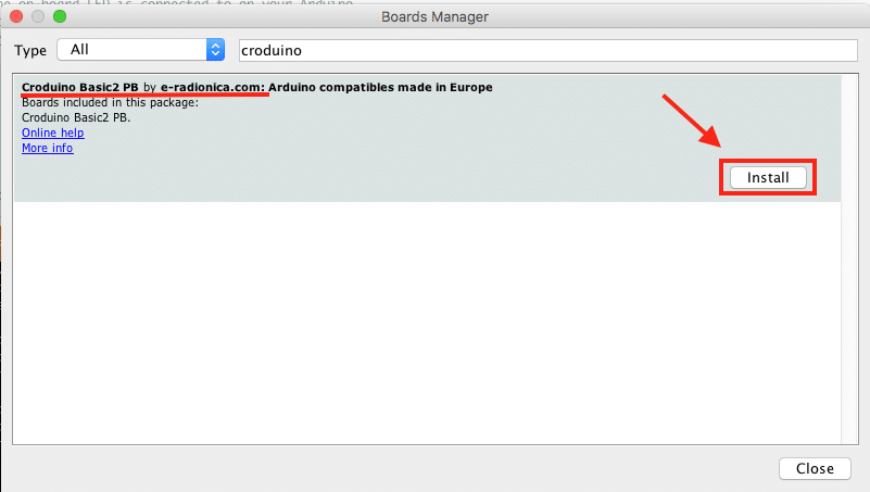

After that, type “croduino” in the search engine. The “Croduino Basic2 PB” by e-radionica.com package will appear. Select and install it.

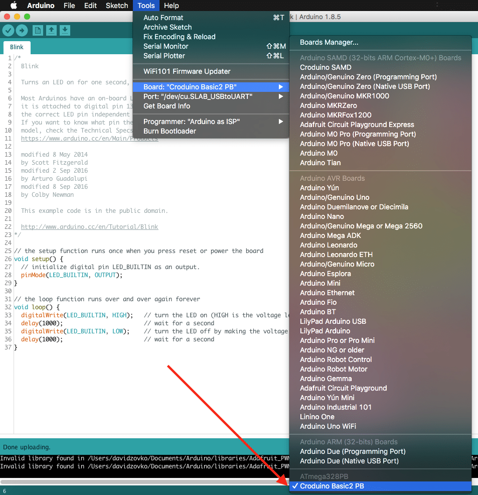

That is it! It is still left to select a Croduino board. Select it by clicking Tools-> Board-> Croduino Basic2 PB.
Select the serial port to which Croduino is connected and you are ready for the upload!

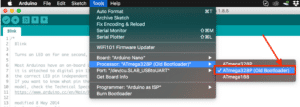

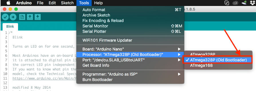

NOTE: IF YOU ARE USING CRODUINO BASIC2 (WITHOUT PB TAG)
If you have the standard Croduino Basic2 which you are planning to use with Arduino IDE, you should change only one option in the Arduino IDE in order for the upload to be successful. Under Tools->Board->Processor select ATmega328P (Old Bootloader). The board remains Arduino Nano!
