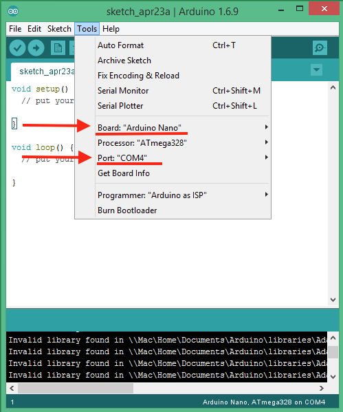

STEP 3: ARDUINO IDE CONFIGURATION AND UPLOAD
You just need to set up Arduino IDE. Two settings are important: board and serial port. Both menus are located under Tools.
Under Tools -> Board, you must select Arduino Nano.
Under Tools -> Port,  you must select a COM with the largest number next to it (COM4 in our example). In Linux, the port will be named ttyUSB0, and in MacOS /dev/tty.wchusbserial.
Right after the setup, you are ready for the upload!
