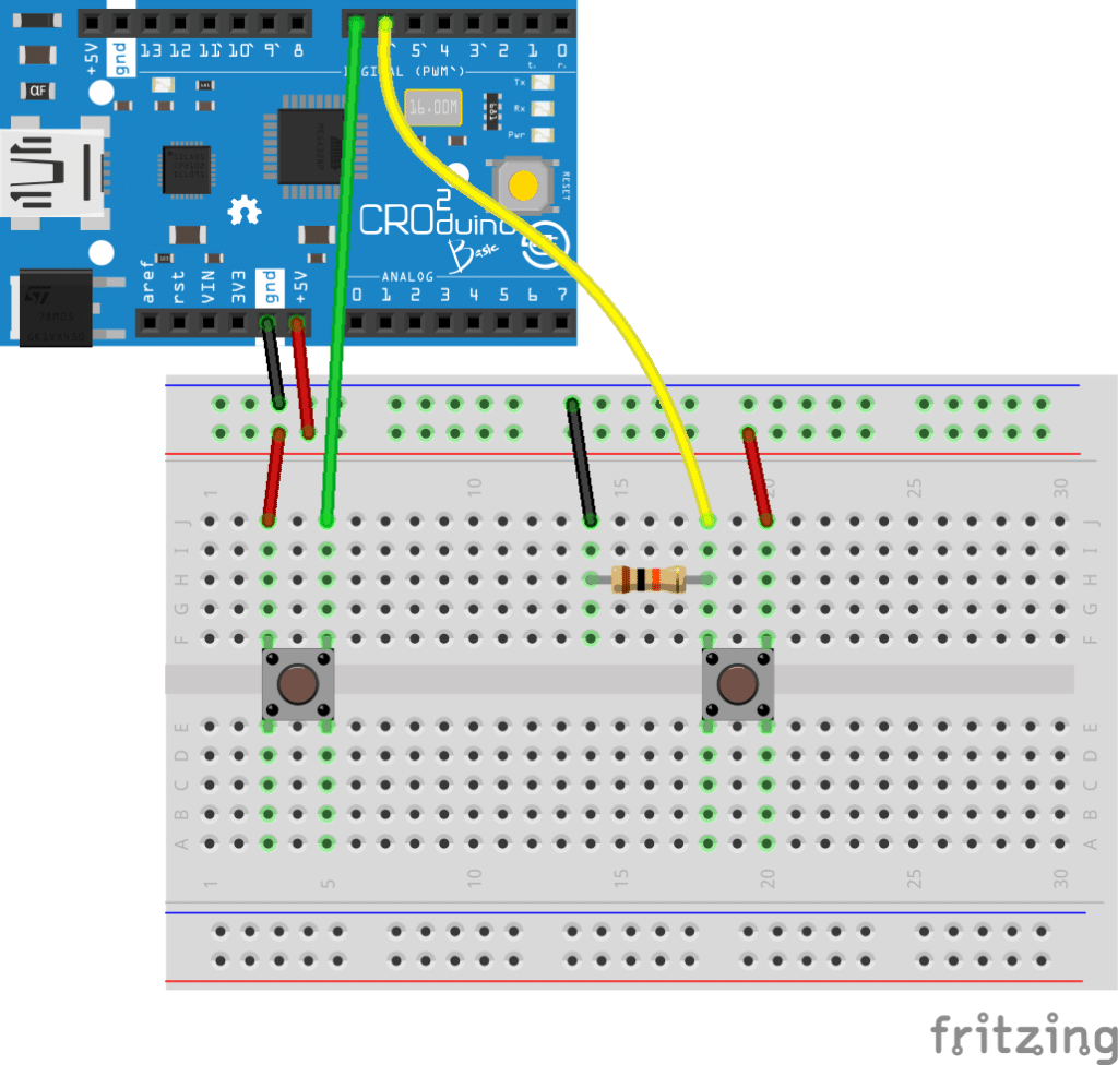

PULL-UP RESISTOR
Each push button must be connected to Dasduino through either pull-up or pull-down resistor. We have already talked about pull-up resistors and Dasduino’s pins floating. Let’s see what happens when the push button has, or does not have its own resistor.
We connect the push button on the left to +5V which will, when under pressure, be switched to digital pin 7. The push button on the right is connected to pin 6, but we add a 10k resistor as shown in the picture below.
What we expect is that Dasduino’s pins 7 and 6 will have LOW(0) readings when not activated, or HIGH(1) when buttons are pushed. Let’s check what is actually happening:

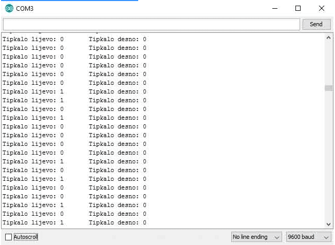

Our readings look approximately like this:
The pin, where the push button without a pull-up resistor is located, floats, therefore it is useless as it is. So, pull-up/pull-down resistor is something a push button can not work without.
