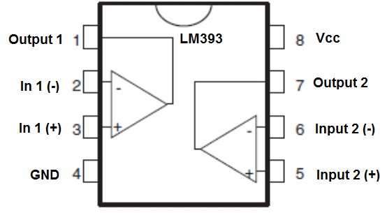

LM393 - PINOUT
LM393 is an 8-pin integrated circuit, as seen in the picture. Two pins are inputs for voltage Vcc and GNDVcc is a positive terminal of the power supply, according to the datasheet up to +36V, while GND is a negative terminal. These two terminals allow the comparator to work. Once we connect the power source to the chip, it needs two voltage comparisons. As it is already mentioned, LM393 has two mutually independent operation amplifiers (op-amp).
ln1(-) and ln1(+) are inputs for the first operating amplifier (Output1), while ln2(-) and ln2(+) are inputs for the second one (Output2). ln1(+) and ln2(+) are non-inverted, while ln1(-) and ln2(-) are inverted inputs.
When the voltage in the non-inverted input is higher than the one in the inverted, output pin goes to the maximum positive value – HIGH (Vcc). In case the non-inverted voltage falls below the invert input voltage, the output goes to the maximum negative value – LOW (GND). The output is, of course, limited to the power values we have brought to Vcc/GND pins.

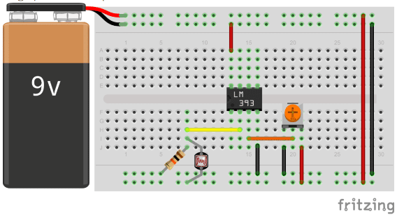

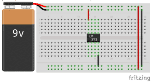

For this project we will use only ln1(-) and ln1(+) inputs and Output1 output. Firstly, we connect the power source to Vcc and GND pin comparator. As a source we can use a 9V battery.

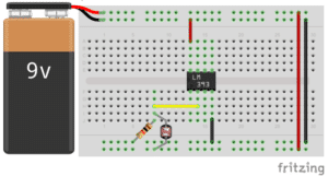

The following step is to make voltage divider with a fixed resistor and a photoresistor. Fixed resistor should be 10kΩ, which will provide an output of 0.429V when the photoresistor is in the dark (it provides 200kΩ resistance) and 7.5V when the resistor is exposed to light (it provides 2kΩ resistance). Whether we will connect this output voltage to ln(-) or ln(+) does not matter in this case, but we will tell you a bit more about it later on. So, let’s connect it to the inverted input, In1(-), yellow wire.
After that we will connect the input voltage for comparison and over 10kΩ potentiometer so that we can adjust the circuit sensitivity. We connect the potentiometer by connecting the reference voltages to the edge pins. On the left pin, we connect the GND, and on the right +9V. The central pin is our output voltage and we connect it to a non-inverted input of the comparator In1(+). The voltage that the input provides depends on the position of the potentiometer. If we turn it completely left, i.e. towards the GND, the output voltage tends to 0V. As we turn it clockwise, the output voltage is proportional to + 9V. For starters, we can put it roughly in the central position.
What is going to happen next is:
    • in the dark: the voltage on the inverted pin In1(-) is lower than that of the non-inverted In1(+), therefore we get GND on the output
    • in the light: the voltage on the inverted pin In1(-) is higher than that of the non-inverted pin In1(+), therefore we get Vcc (+9V) on the output

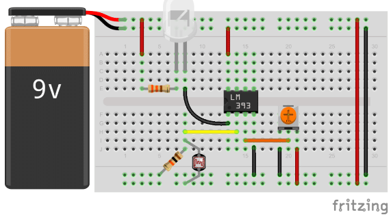

Since we want the LED diode to light in the dark, the Output pin will be connected to the cathode(-) of the LED diode, while we will connect the anode (+) over 330Ω to + 9V.
In case we replaced the inverted and non-inverted input on the voltage comparator, they would get +9V on the output, in the dark. Then we would only connect that output to the LED module anode while connecting the cathode to GND. Of course, through some resistor.
