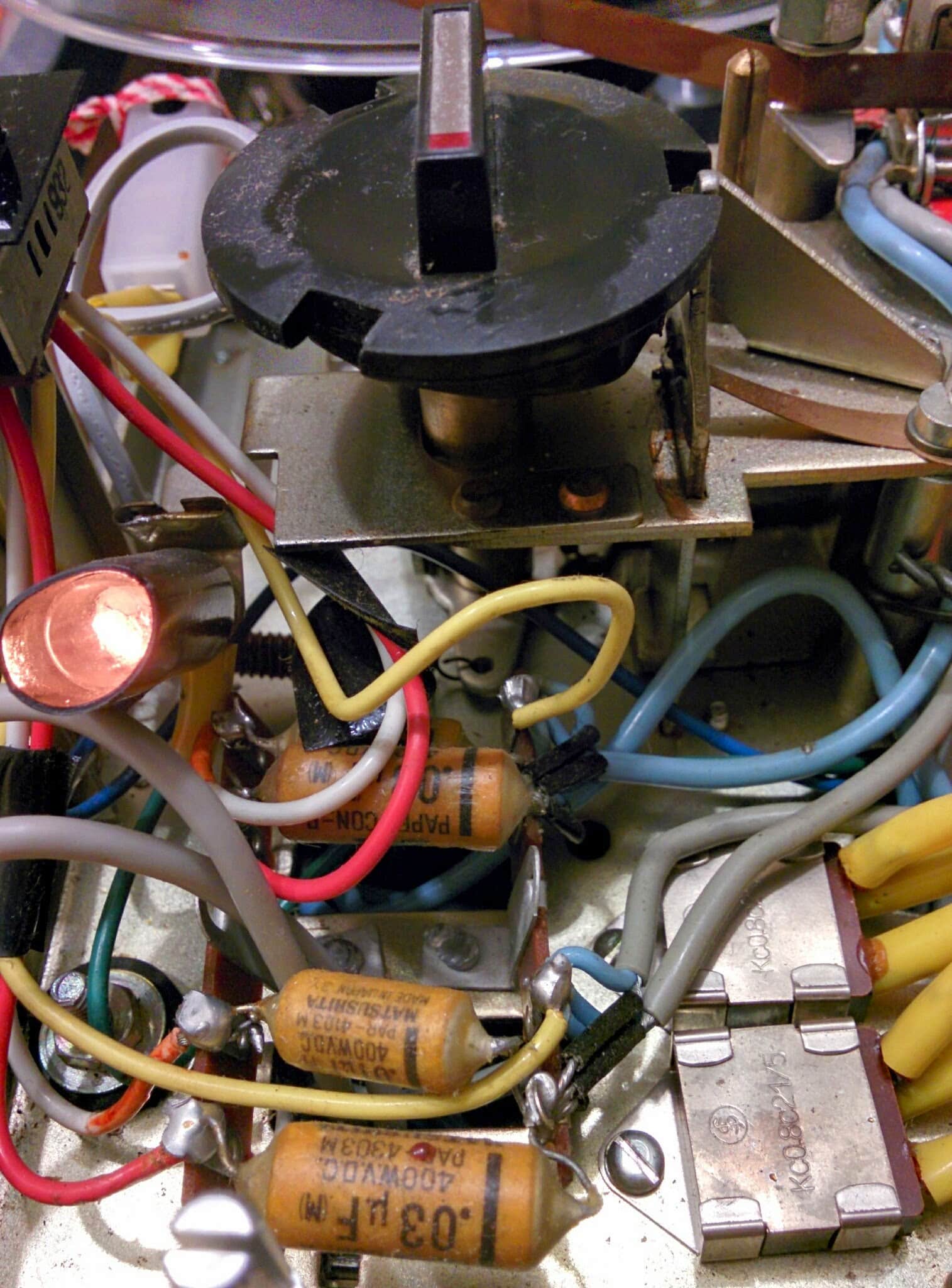

Early electronic components and devices were manufactured and connected using point-to-point construction. It was essentially a group of wires and components connected directly to each other. Very easily this could become a mess, everything overlapping everything. This led to many difficulties in both scaling up the production and repairing the damaged devices. You can see an example of point-to-point construction below. Imagine making your electronics projects like this today. Pretty much a nightmare!

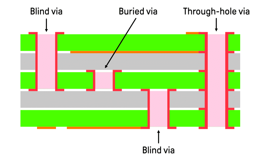

  • Blind via – a via connecting the external PCB layer to one or more inner layers

Types of vias

  • Buried via – a via connecting the inner layers of the board, not visible from the outside

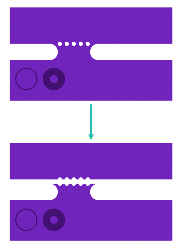

  • Mouse bites – a line of tiny drilled holes clustered close together, creating a weak spot where the board can be easily broken to be separated, very similar to holes around postage stamps

Mouse bites

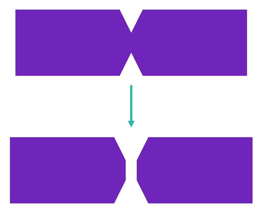

  • V-score – an incomplete or partial cut through a panel or a board, allowing the boards to be broken apart into single units

V-score
  • Via – a plated-through hole on a PCB used to pass signals between layers, has a conductive copper interior for electrical connection
