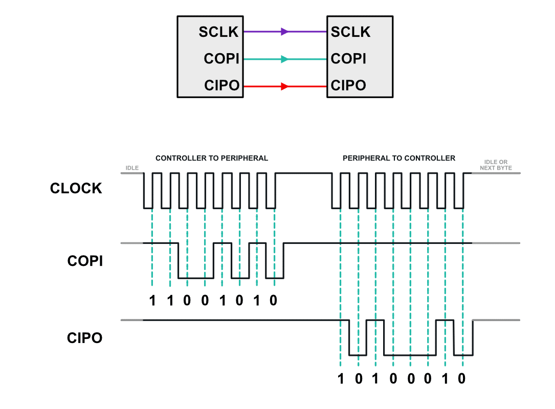

Sending data
To begin a new data transmission, the controller will first put the chip select pin from high to low. In other words, from logical 1 to logical 0. Once a peripheral is selected this way, the controller will then generate a clock and start sending data signals. To simplify this, we will first focus on only one peripheral.
Let’s send the first letter of our name with SPI. The controller will send bits of data on either the rising or falling edge of the clock signal. Let’s make it simple for this example and say it will use the rising edges.
What is the SPI communication protocol
Capital S in ASCII is 01010011. Since serial communication usually sends data with the least significant bit (LSB) first, we will reverse that order to get 11001010. When the receiver (device receiving data) detects the rising edge on the clock, it will look at the data line (COPI) to read the information bit.
Receiving data
When you want to send the data from the peripheral to the controller, you will use the separate CIPO line. As the name suggests, the data goes “in” the controller, and “out” of the peripheral. The data will be sent back on the predetermined number of clock cycles. The controller will have to know beforehand whether the peripheral will return some data and how much. If it doesn’t, it won’t know how many clock signals it should send, and some data might get lost.
Let’s look at another example. This time, let’s make the peripheral send capital E when it receives data from the controller. Capital E in ASCII is 01000101, so it will be sent as 10100010. As seen from the image below, the controller will generate two clock cycles. During the first, the controller will send data, and the peripheral will be idle. During the second cycle, the controller will be idle, and the peripheral will send some data back.
Since SPI is full-duplex, this could’ve happened simultaneously. For simpler illustration purposes, we divided this to make it clear.

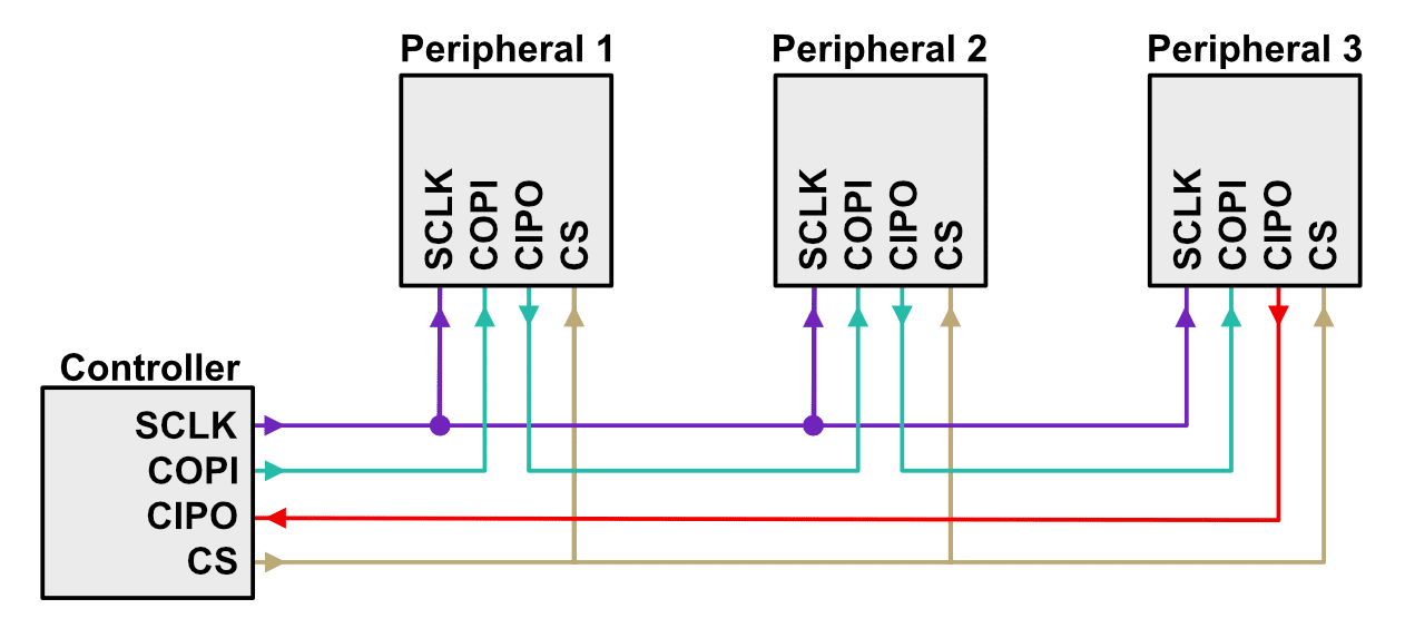

Let’s look at the regular mode first. The controller will have one of each SCLK, COPI, and CIPO line, but it will have multiple CS lines, depending on the number of peripherals. Peripherals can’t share the same CS line, each one must have its own.
To send data to a specific peripheral, the chip select signal needs to be enabled by the controller. This means that the signal on the CS line will be pulled low, while others remain high. This, figuratively speaking, makes the peripheral take a look at the data. All the others will see the data being sent, but since their signals are high, they won’t look at it.
The clock and data on the COPI/CIPO lines are only available to the selected peripheral. If more than one peripheral is selected (their signals are low), the data on the CIPO line will be corrupted. There will be no way for the controller to figure out which peripheral is sending the data to it.
As seen from the image below, as the number of peripheral rises, so does the number of CS lines. This easily takes up a lot of I/O pins from the controller and limits the number of peripherals. This mode sacrifices the number of peripherals that can be connected for the speed of data transmission.

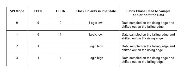

We mentioned earlier that data bits can be sent on either rising or falling edge. So far we’ve only been talking about data transfer on the rising edge. To determine whether the data is sent on the rising or falling edge, the controller configures clock polarity (CPOL) and clock phase (CPHA).
CPOL sets the polarity of the clock signal when it is not active, or in the so-called idle state. The idle state is a period when the chip select is high and transitioning to low at the start of a transmission, as well as when it is low transitioning to high at the end of that transmission. CPHA selects the clock phase, meaning it uses rising or falling clock edge to sample and/or shift the data.
Clock polarity and phase enable the SPI communication with different types of serial devices. Both CPOL and CPHA can have two states, either 0 or 1. Four SPI modes are available depending on the states of CPOL and CPHA bits. Let’s check the table below to get a clearer view.
One thing to keep in mind, if CPHA is 0, data is captured on the first clock edge, no matter if it’s rising or falling. If CPHA is 1, the data is captured on the second clock edge. The data must be stable for a half-cycle before the first full clock cycle if this is the case. Below are some visual examples of these four SPI modes.

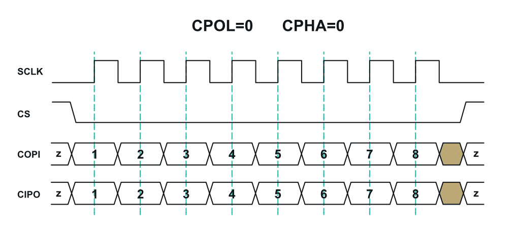

In SPI mode 0, there is no delay in clock pulses. The data is sampled on the rising SCLK edge and shifted out on the falling edge. The clock polarity in the idle state for this mode is low.

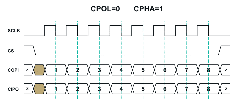

In SPI mode 1, the clock pulses start after a bit of delay (half-cycle). The data is sampled on the falling SCLK edge and shifted out on the rising edge. The clock polarity in the idle state for this mode is low.

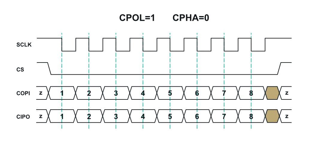

In SPI mode 2, there is no delay in clock pulses. The data is sampled on the falling SCLK edge and shifted out on the rising edge. The clock polarity in the idle state for this mode is high.

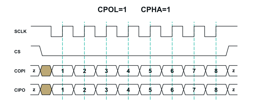

In SPI mode 3, the clock pulses start after a bit of delay (half-cycle). The data is sampled on the rising SCLK edge and shifted out on the falling edge. The clock polarity in the idle state for this mode is high.
