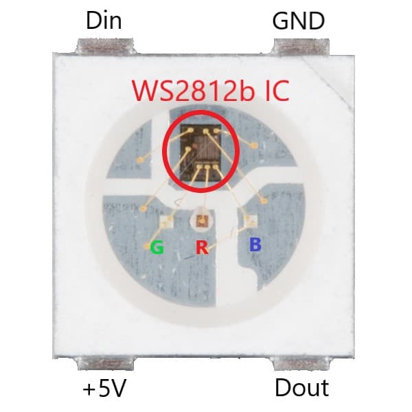

Diode type: WS2812b SMD LED (5050 LED diode with a built-in IC)
Protection: IP20
Dimensions: 10mm width, 2mm thick
HOW DOES IT WORK?
The reason why this LED strip is so special is the way we can control it. WS2812b is the name of an integrated control chip that manages RGB LEDs. What we see on the strip are actually 5050 (5.0 x 5.0 mm) housings. Inside, there are WS2812b IC and 3 leds (red, green and blue). WS2812b IC communicates in a very practical one-wired way using the NZR communication protocol. Each chip has a Din and Dout pin so that it is possible to cascade them into longer series. The strip can be extended in a way that we connect the Dout pin of the previous LED to the Din pin of the next one, but we must pay attention to current consumption, because it can easily become too demanding for the microcontroller.

– WS2812B chips have a built-in reversed polarity protection on their strips, i.e. if you accidentally replace +5V and GND, the ICs will not be ruined. However, it is certainly better to check the connection once again.
– Each pixel of three primary colors (R, G, B) can assume 256 (0-255) levels of light, meaning 16 777 216 (256^3) different colors
– ICs have a built-in circuit for constant current that ensures optimal lightness of LEDs

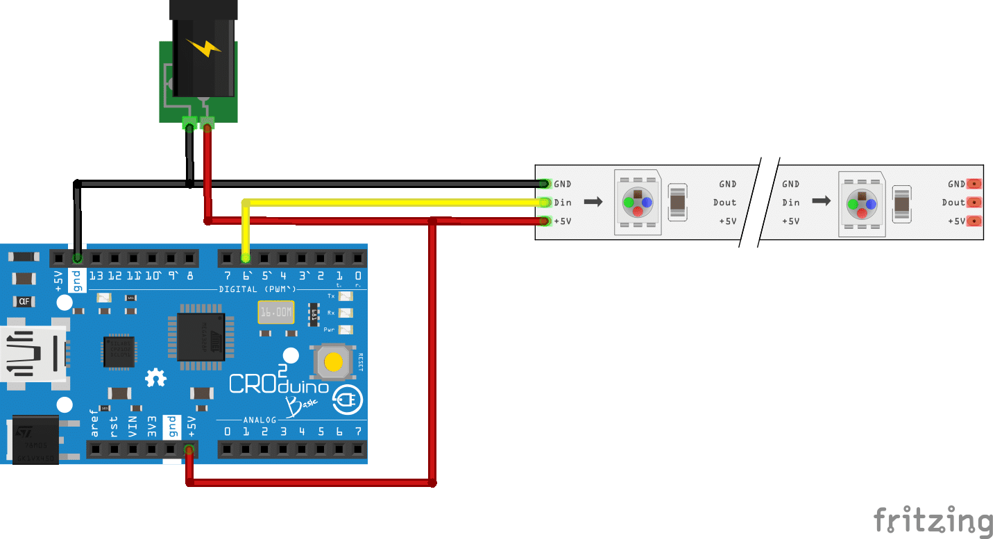

CONNECTING
It is best to supply the strip through an external power supply source, because the microcontroller does not have high output power, but make sure you have a regulated 5V. The same source can be used for Dasduino power supply over the +5V pin. Once again, a note, for supplying both Dasduino and the strip, you must have a 5V power source, voltages higher than 5.3V can damage Dasduino or the strip, and voltages lower than 3.5V will not be sufficient for proper work.
